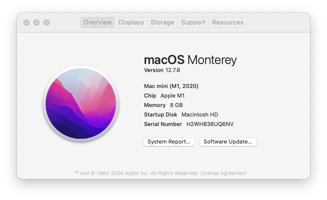

To open a System Report, you first must go to the Apple Menu (always in the upper left of the top menu bar) and select the option "About this Mac." A new window will open with information about the MacOS version, looking something like Figure 1 below:
Fig. 1. The "About this Mac" window.
In the window, click on the choice "System Report..."

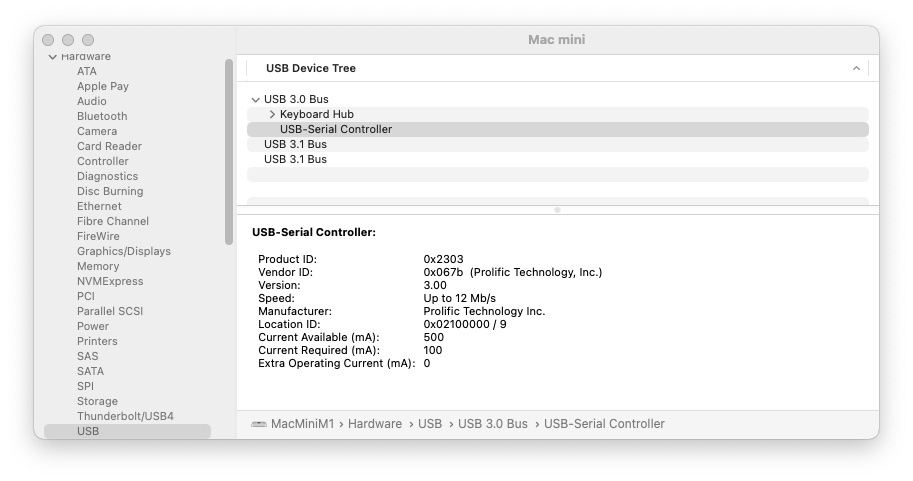

Another new window will open that contains a very comprehensive report about every element of the operating system. Under the Hardware tab, locate the USB option. This will show the USB Device Tree. Click on the entry for USB-Serial Controller. There you should find data about the BU-353, however the specific identification "BU-353" will not be there. Instead you will find a entry of
    Product ID:	0x2303
    Vendor ID: 0x067b (Prolific Technology, Inc.)
    Version: 3.00
    Speed: Up to 12 Mb/s
    Manufacturer: Prolific Technology Inc.
    Location ID: 0x02100000 / 9
    Current Available (mA): 500
    Current Required (mA): 100
    Extra Operating Current (mA):
This is the BU-353 GPS and its USB connection point, and it should look something like this in the report screen:
Fig. 2. The USB Device Tree entry for the BU-353 GlobalSat GPS receiver.

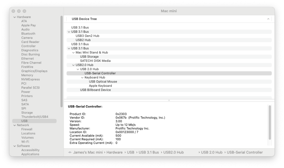

Using the BU-353 with the MacMini M4 and MacOS15.6 adds a few more wrinkles.
The location of the System Information app that generates the System Report has moved, and is now located in the path
Applications(folder) --> Utilities(folder)---> System Information (app).
The MacMini M4 computer does not have any native USB ports, so I am using an auxiliary dock, a Satechi MacMini M4 model, which creates three new USB ports. The BU-353 GPS receiver will be connected to one of the three USB ports on the Satechi dock, so you must look for it there. The USB tree below shows the information and Port ID.
Fig. 3. The USB port device tree on a MacMiniM4 with Satechi dock. The GlobalSat BU-353 appears as a Prolific driver device with product ID 0x2303 and location ID 0x00123000 / 7
The location name of the BU-353 device's USB port has changed,and it will now appear in the /dev/cu directory as
/dev/cu.usbserial-1230
