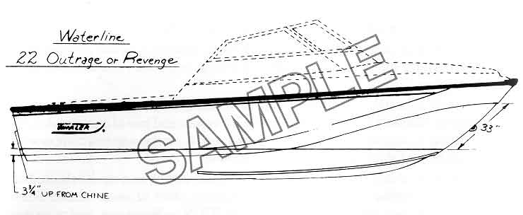

Approximate water line drawings for all models 18 thru 25 are available. However, these may vary slightly because of the variety of engine combinations and individual equipment on each boat. The best method to determine the exact water line on our boat is to launch and mark the bow and stern. The boat can then be hauled, leveled athwart ship, and trimmed fore and aft so the bow and stem marks are equal distance from the level floor. A piece of wood cut to the distance between the floor and the marks can be used to guide further marks completely around the hull. Mask off to this line. Raising the water line to be two or three inches higher than the float line will prevent scum marks from appearing on the gelcoat.
Dwg: Water line sample
