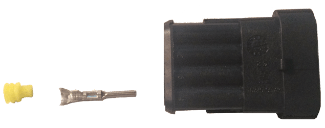

One source of the proper connector to convert an existing drop cable to a specialized drop cable for E-TEC is MOUSER ELECTRONICS. Here is a possible parts list with their part numbers:
Connector seals = PN 571-2819342
Connector pin contacts = PN 571-183024-1
Connector body = PN 571-282106-1

AmpSeal 1.5 four-pole MALE connector for connecting to E-TEC engine; seals, contact, and body are shown.
