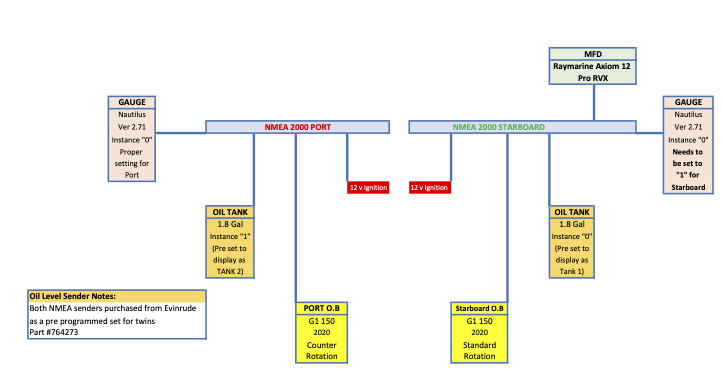

My setup;
Boat : Zodiac Hurricane 7.33 Meter
Starboard
2020 E-TEC G1 150 (standard rotation)
Nautilus 3.5 inch Gauge (Version 2.71)
1.8 Gallon Oil tank with Evinrude oil level sensor and sender
Instance - 0
Referenced as Tank - 1
Port
2020 E-TEC G1 150 (counter rotation)
Instance - 1
Referenced as Tank - 2
Fig. 1. Evinrude NMEA-2000 Network
Evinrude Network.png (43.82 KiB) Viewed 19019 times
Q1
Neither of my Nautilus gauges will recognize the new OEM oil tank senders that I recently installed. I uploaded the latest version of firmware (2.71) last week, is there a reboot procedure I may have missed?
Q2
The auto Winterization feature doesn't initialize, any suggestions on why it isn't working ?
Please note:
- I have two separate NMEA 2000 networks, one for each motor. The reason is that the previous owner didn't change the instance settings to reflect a twin configuration. Both outboards are currently set at Instance - 0.
- My intent is to purchase the Diagnostic Software and make the proper Instance adjustments or have a local dealer do it.
- I'll attempt to attach a diagram of my network for reference.
Thank you
Higher resolution image in PDF format also available.
Evinrude Network.pdf
(107.09 KiB) Downloaded 549 times

Hello. Thanks for including the very nice diagram with excellent notations. I made it into a PNG file that can be shown as an in-line element to allow readers to see the diagram.
With the EV-Diagnostics Software Version 5 you can alter the INSTANCE settings of the two engines to properly reflect the twin engine configuration. However, with Version 5 you will only be able to connect to the EMM of the E-TEC.
The NAUTILUS gauge is a NMEA-2000 device. Evinrude developed EV-Diagnostic Version 6 to connect to the G2 engines via NMEA-2000. This also gave the Version 6 software a chance to connect to NMEA-2000 displays and devices, such as NAUTILUS gauge and the fluid tank level senders. Thus with EV-Diagnostic Version 6 you could check the INSTANCE settings of the sender, but you cannot do that with Version 5.
NO OIL TANK LEVELS SHOWN ON NAUTILUS
About the only ODD thing I see in the oil tank settings is that the PORT network has an engine at INSTANCE =0 and the oil tank is at INSTANCE =1. This may be confusing the gauge.
On the STARBOARD network, the engine also has INSTANCE =0 and the oil tank also has INSTANCE =0, so this network and NAUTILUS gauge should be working correctly. You mention it is set to show as TANK 2, so that might also be a conflict. Try configuring to show as TANK 1. (I am not quite clear on what you mean by these designators.)
I am not familiar with the RAYMARINE AXIOM display.
Q3: does the AXIOM display have a NMEA NETWORK device list function that will show you the type and instance and address of all attached devices?
If the AXIOM has the network device display function, it could verify that the oil tank level senders have been properly configured.
The reason for doing this would be to confirm that the oil tank senders you have purchased actually have been properly configured for INSTANCE and TYPE settings.

More information about INSTANCE and TYPE settings is given in a separate article at
INSTANCE Settings for FLUID TANKS in E-TEC G2 Rigging
https://continuouswave.com/forum/viewto ... 387#p24948
This is appropriate for the NAUTILUS gauge as it was designed for the G2 engine.

I may have incorrectly identified the OIL Tanks as Tank =1 and Tank =2 in my initial post, however, I previously read that in addition to the Instances being preset, the tank senders were also preset to display as 1 or 2, when multiple tanks are shown on a NMEA MFD display.
I'm leaning to believe that my problems may be due to the twin engines not being set to the proper Instances PORT =0, STARBOARD=1. I spoke to my E-TEC service technician today, he'll make the proper adjustments when I bring my boat in at the end of the season.
I also, now realize that I incorrectly labelled my gauges in the diagram as INSTANCE =0 and INSTANCE =1, they in fact are only displaying data sent from each motor's EMM.

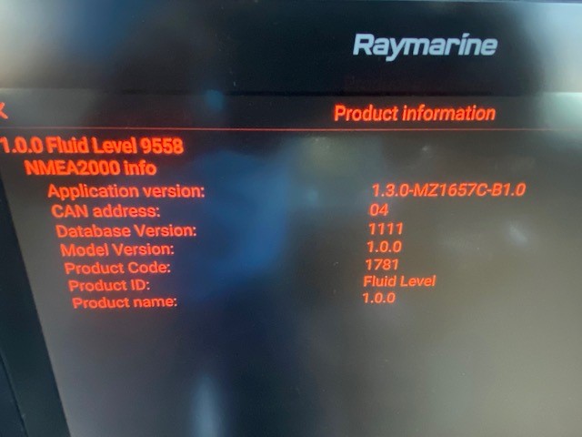

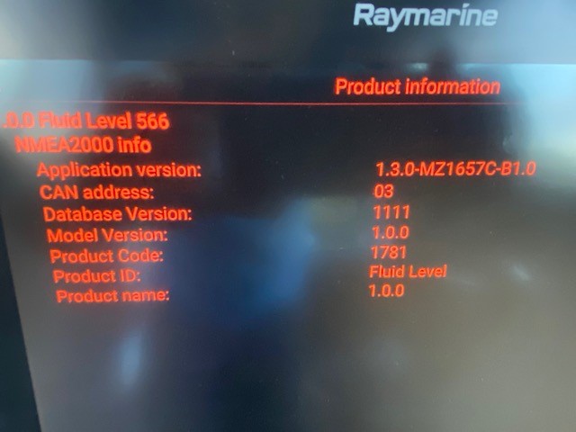

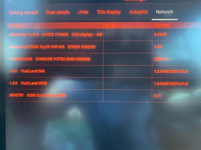

Q3: AXIOM Network Display
Yes, my Axiom displays data from all devices. I temporarily connected both OIL TANK Fluid Level senders to my Axiom network, both senders displayed information on the Network. I'm unfamiliar with the data, I can't determine where the INSTANCE # is referenced.
I'll attached pictures, but here is the data from the display:
PORT OIL TANK Sender
1.0.0 Fluid Level 9558
Application Version : 1.3.0-MZ1657C-B1.0
CAN Address: 04
Database Version : 1111
Model Version : 1.0.0
Product Code : 1781
Product ID : Fluid Level
Product Name : 1.0.0
STARBOARD OIL TANK Sender
1.0.0 Fluid Level 566
CAN Address: 03
Product Code : 1781
ggeldart1
Joined: Wed Oct 05, 2022 8:21 pm
Re: Legacy E-TEC and Nautilus Gauge
Postby ggeldart1 » Thu Oct 06, 2022 8:58 pm
Below are three screen captures from the Axiom display NETWORK function:
Fig. 2, Starboard oil tank sender.
Axiom Network - STARBOARD.jpg (46.87 KiB) Viewed 18981 times
Fig. 3. Port oil tank sender
Axiom Network - PORT.jpg (47.22 KiB) Viewed 18981 times
Fig. 4. Axion Network application listing of devices found on the NMEA-2000 network.
Axiom Network.jpg (58.54 KiB) Viewed 18981 times

Regarding the data shown in the screen captures from the RAYMARINE display network data application:
I am not familiar with the Raymarine terminology, but it does not show specifically a value for INSTANCE.
In NMEA-2000 networking, if there are two or more identical devices on the network, then they must be separated by their INSTANCE number. I don't know if the Raymarine lablel "CAN address" is the equivalent of INSTANCE.
Perhaps you can contact Raymarine support and ask them this question:
Does "CAN address" mean "INSTANCE"?
Or perhaps the "CAN address" values ( 3 and 4) are the network addresses. I notice that in the list shown in Figure 4 that the fluid tank level devices are listed in an order that would correspond to the address being 3 and 4 if the address numbers started at 000.
I think your best path forward to resolving this problem will be to have an Evinrude dealer connect to your network using the EV-Diagnostic version 6 software. With that diagnostic tool, the set-up of the fluid level tank senders can be checked and perhaps re-configured if incorrect. The goal, as far as I can tell, for a NAUTILUS gauge is to have the fluid level senders configured at TYPE=OIL and as INSTANCE 000 and 001 corresponding to PORT and STARBOARD engines.
Also, I think you can collapse your split networks into one NMEA-2000 network once you get the proper INSTANCE settings on the engines.
