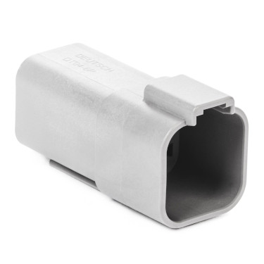

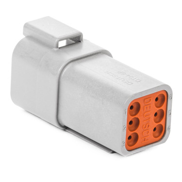

Here are the components for the connector for the engine-side of the bootstrap adaptor cable. The links are to a vendor that has these parts in stock and has reasonable prices for low quantities of the parts.
DT04-6P Receptacle with Pins
Connector Housing
Fig. 2A. Front view DT04-6P receptacle housing
FIG. 2B. Back view DT04-6P showing wire entry seals and pin position embossed identity marking.
DT-04-6P 6-pole Gray Receptacle, Pins
$2.87 each; one required
https://www.buydeutsch.com/collections/dt-series/products/dt04-6p

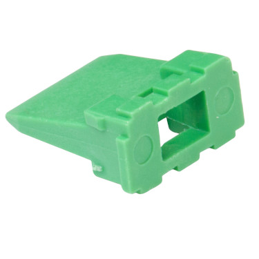

Wedgelock
Fig. 3. Wedgelock 6-pin
W6P Wedgelock for 6 pin receptacle, green
$0.28 each; one required
https://www.buydeutsch.com/products/w6p

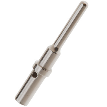

Solid Pin Contacts
Fig. 4. Solid pin contact.
0460-202-16141 Solid pin contacts AWG-16 to AWG-20 13-Amperes Nickel
$0.25 each; five required
https://www.buydeutsch.com/products/0460-202-16141
The solid pin machined contacts are the most durable and very inexpensive from this vendor. To use them as intended as a crimp connector, a special circumferential crimp tool (that is very expensive) is recommended. However, with careful technique a wire conductor can be soldered into the connector, but you must certain to not leave solder residue on the outside diameter of the contact as it will interfere with the press-fit or snap-in fit of the connector into the housing and wedgelock. I have used these with solder with good results with a micro-tip and low wattage soldering pencil, but I have about 65-years of soldering experience which may have helped. This vendor also has conventional crimp-style stamped pin contacts available if you prefer those.

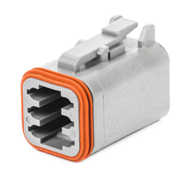

DT06-6S
DT06-6S Plug 6-pole Housing Gray
Fig. 5A. DT06-6S front view.
Fig. 5B. DT06-6S back view showing wire seals and embossed contact position number markings,
$3.30 each, one required
https://www.buydeutsch.com/collections/ ... ts/dt06-6s

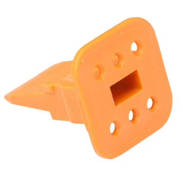

WS6 Wedgeplate, orange
Fig. 6. Wedgeplate
$0.25 each, one required
https://www.buydeutsch.com/products/w6s

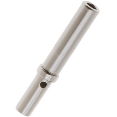

Machined Sockets
Fig. 7. Machined socket
0462-201-16141 Solid Socket 16-20 AWG 13-Ampere Nickel Plated
$0.54 each, four required
https://www.buydeutsch.com/products/0462-201-16141
