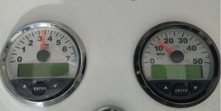

A long time ago I bought I-command gauges 352679. I did not buy the other components to install them, that is, the Power Hub, Consolidator Hub, network Data, Terminator Harness, Emm to power Hub Harness.
Fig. 1. Gauges described as "I-Command" gauges.
Can this NMEA 2000 system be adapted to the new [DeviceNET Micro C connectors and] wiring with T-Connectors which is much easier to install?

The gauges are I-Command “Classic” Instruments with NMEA 2000.

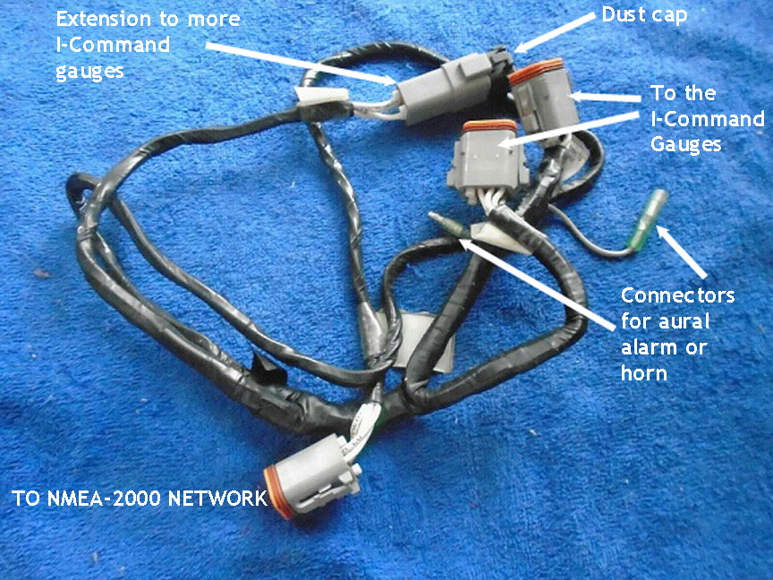

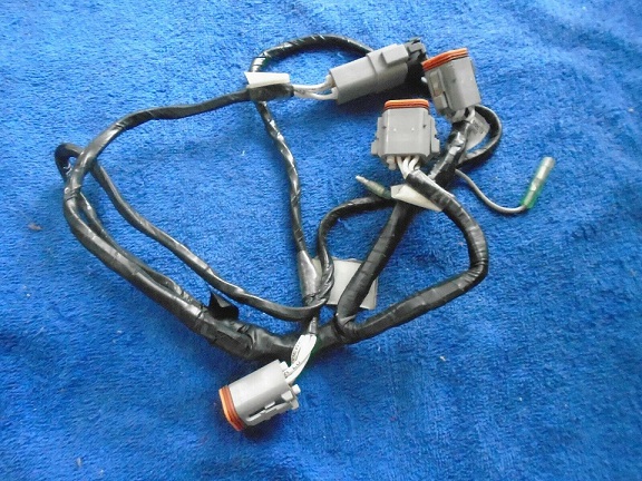

Hello Jimh, I have not bought anything, I only have the tachometer, the speed indicator and the cable that connects them with the Deutsch 6 pin connector, as I show you in the photo. I have to buy the NMEA 2000 Network. Which one do you recommend what kind of connector you should have? Beside the Deutsh connector, all the cables are white, how do I connect it?.
Fig. 2. A wiring harness.

The wiring harness you have now revealed in your illustration (Fig. 2) above looks more like a an old, obsolete harness--but probably is for NMEA-2000 components, just with very out-of-date connectors
Read:
I-Command Installation and User Guide
http://continuouswave.com/whaler/reference/NMEA2000/I-CommandInstallation.pdf
Refer to the diagram "COMPONENT CHART" on Page 10. Refer to item with CALLOUT 12, called the "TACH SPEEDO HARNESS #763358." That is probably the cable you have on hand.
This cable appears to perhaps be a NMEA-2000 cable. You connect the two gauges, TACH and SPEEDO, to the two appropriate connectors on the harness.
There are two other connectors on the harness. One connector will be for connecting to a NMEA-2000 network (as shown by going to a HUB device). The other is for extending the network to more I-COMMAND gauges, if any, that are close to the TACH and SPEED gauges.
You MAY be able to use this with a modern NMEA-2000 network with DeviceNET connectors. The easiest way to do this will be to cut off one of the network connectors on the harness, and wire it to a DeviceNET connector.
If I were trying this, I would look to see if the two network connectors on the harness mate with each other. If they do, then one connector will have pins and the other will have sockets. I would simply cut off the connector with the sockets from the harness but leaving enough wire attached at the connector be be useful for making a splice to another cable, Then insulate the wires on the harness. Then I would get a DeviceNET cable. I would cut it in to, and then wire the DeviceNET cable to the connector I cut off the harness, making an ADAPTOR. Then the connector on the harness will mate to the harness-style connector on the adaptor.
CAUTION: it looks like there is a 12-Volt power connection as part of the obsolete cable you have. I have no idea how the power is wired with this harness. Read the comments in the article I linked to (above) about NMEA-2000 network power.
ASIDE: if providing an image of a wiring harness with multiple connectors, the arrangement of the connectors in the harness would be more clearly seen if the cable were not photographed while in a tangle.

The wiring harness seen above in Fig. 2 appears to be wired with all conductors having white insulation. There may be some printed information on each conductor that identifies the signal or voltage being carried on the conductor. If there is such an identification mark, use that information to identify the signal when making a connection to a conventional NMEA-2000 cable with the DeviceNET Micro C connectors. Generally with NMEA-2000 extension cables the conductors will have different insulation colors which will identify the signals. For advice on identification of conductors and their signals, see my article on that topic at

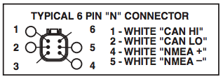

Also note that, in the Evinrude I-Command Installation and User Guide literature for these gauges on Page 25, a detail in an illustration shows the connector layout and identifies which signals are in which pole position of the six-pole Deutsch connector. This will also give you guidance on how to make the connection between this obsolete cable and a modern NMEA-2000 DeviceNET Micro C Extension cable. However, be careful. The designations used in the illustration are somewhat ambiguous with regard to which pair is a power source and which pair is a data pair. I would hope that the printed designations on the wires are more clear about which signal or voltage is being carried.

Postby jimh » Mon Jun 03, 2019 11:26 am
Fig. 2. Older I-Command wiring harness with callouts added
It is not clear to me in the above illustration if the network extension connector has all five circuits provided. If it only has three (the two data circuits and the shield), then it won't be immediately useful as I suggested earlier to make an adaptor cable.
Note that these connectors can be disassembled rather easily and the actual contacts removed. The contacts are loaded into the back of the connector body. The front face of the connector usually can be pried out from the connector body. This should reveal the latches that will release the contacts. By careful disassembly you could salvage the connector, although you may need to get new contacts. An Evinrude dealer or an electronics distributor will have these contacts. I suspect they OEM assembler used crimp contacts, which generally cannot be removed and reused.
Your ability to work with electrical connectors is unknown to me. If you have a few basic tools you can probably accomplish the disassembly of the connector and perhaps salvage most of it for reuse.

Postby jimh » Mon Jun 03, 2019 5:28 pm
Fig. 3. Illustration of 6-pole Deutsch connector used in legacy I-Command NMEA-2000 networks. From Evinrude literature.
I would take a GUESS at interpretation of the above labels and their equivalents in a pre-made cable using the standard NMEA wire insulation colors as follows:
CAN HI = White
CAN LO= Blue
NMEA + = Red
NMEA - = Black
