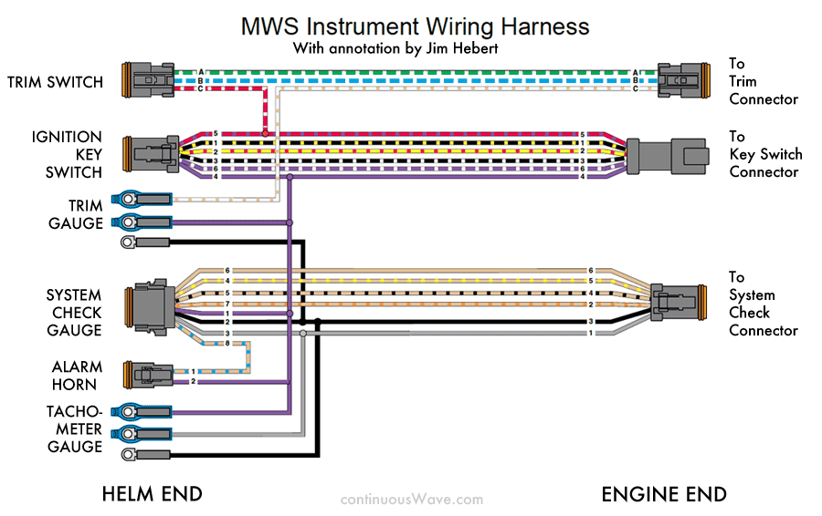

If is also common that and E-TEC engine might be installed with an MWS Wiring harness. The MWS Harness is shown below in Figure 1.
Fig.1. The Evinrude MWS wiring harness, from a diagram by Evinrude, but with annotations to identify the circuit functions.

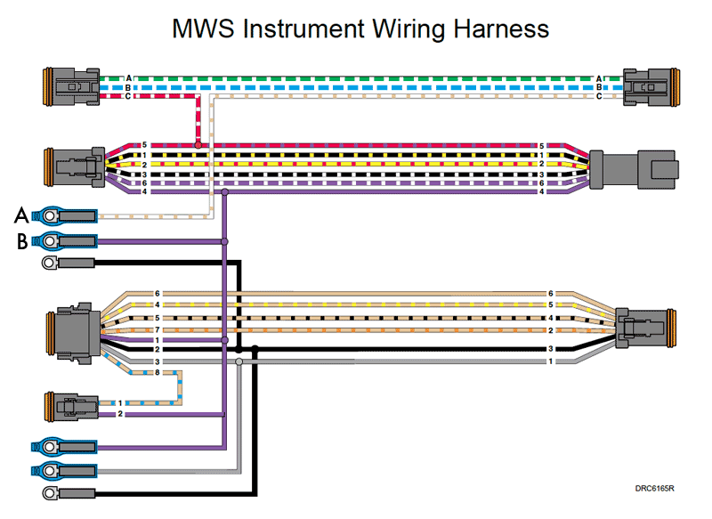

One method to supply current is to install a 47-Ohm 5-Watt resistor into that wiring harness. This modification can be easily made by using the existing loose wiring conductors in the MWS WIRING HARNESS as shown below in Figure 2 by connecting the external resistor at terminals marked A and B:
Fig. 2. To adapt an MWS wiring harness to supply current to the TRIM SENDER, connect a 47-Ohm 5-Watt resistor between callout A and B as shown above.
