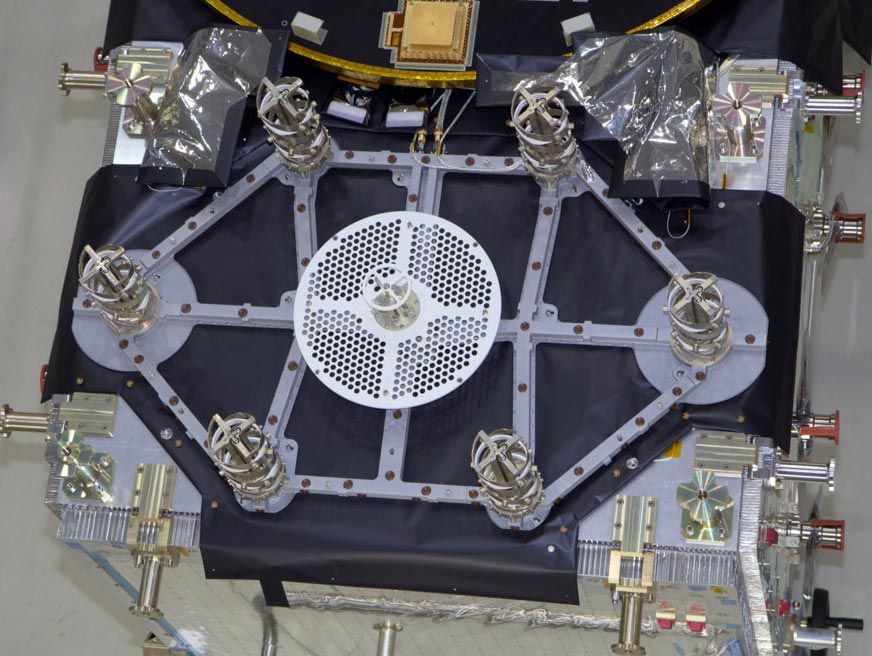

The GALILEO FOC-series space vehicles also contain a 406-MHz SARSAT receiver. The antenna for the 406-MHz band is not a little added afterthought; it is a six-element array of helical antennas. The antenna is shown in detail below. It occupies considerable space of the nadir deck on the spacecraft; compare it to the main navigation antenna, seen in Figure 2, below.
Fig. 1. GALILEO FOC satellite 406-MHz antenna; image from OHB and ESA.
In the center of the 406-MHz array is the L-band downlink antenna. The SARSAT signals are retransmitted to ground stations using this antenna.

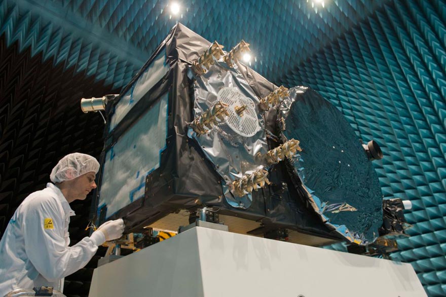

Considering the cost-per-kilogram to put something into orbit, the inclusion of the two antenna systems and the bent-pipe transponder for SARSAT must represent quite an added expense for the GALILEO program just in terms of the launch payload weight, as well as the power requirements to operate all the electronics for SAR, room on the space vehicle for the devices, and overall engineering of the satellite system.
Fig. 2. GALILEO satellite in anechoic test chamber; the inclusion of a human gives a good perspective to the size. Image from OHB and ESA.

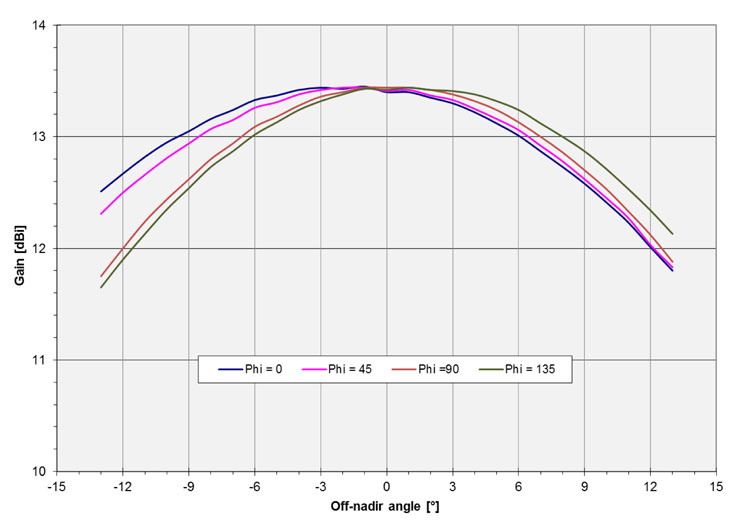

In Table 4.3, a value is given for antenna gain at the "edge-of-coverage" which is explained in a footnote to be for signals with a 5-degree elevation angle to the satellite from Earth. The array gain at that receive angle is 11.6 dB.
The antenna gain is specified for right-hand circularly polarized (RHCP) signals. I presume the typical EPIRB transmitter is also using RHCP. The cross-polarity response of the antenna is not very encouraging; LHCP response is typically lower by 9 to 15 dB.
The cited publication also includes this graph of antenna gain for the 406-MHz receive antenna on an earlier GALILEO satellite:
Figure 3. SAR Rx Antenna Gain on Galileo IOV 419 Satellite (Four Cross-Sections)
The above graph shows the 406-MHz SAR receive antenna has considerable gain, peaking at over 13.4 dB at 0-degree nadir angle. That is more like what I was expecting to find. Assuming a signal arrives at -135 dB, with 13.4 dB antenna gain the receiver could be getting a signal at about -122 dBm, which is generally strong enough for good reception. As discussed in another article, the antenna on a MEO satellite would only have to look for signals at a maximum of 13-degrees off nadir.

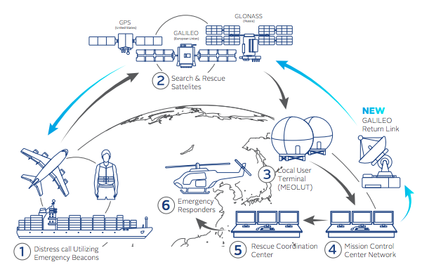

Fig. 4. Diagram of signal flow for Return Link Service in GALILEO SARSAT. From Orolia literature.

The fashing blue light [acknowledgment signal] is sent around 15-minutes after confirmation that the distress signal has been detected and the beacon[']s location independently located.
The delay of 15-minutes implies that the acknowledgement is not autonomously generated by the GALIELO system, but originates in the SARSAT system.
Actual availability, delivery, and use of the new FAST FIND RETURN LINK PLB will have to wait for the GALILEO system to bring the Return Link System to full operation status; this is anticipated to happen in early 2020, according to Orolia.
