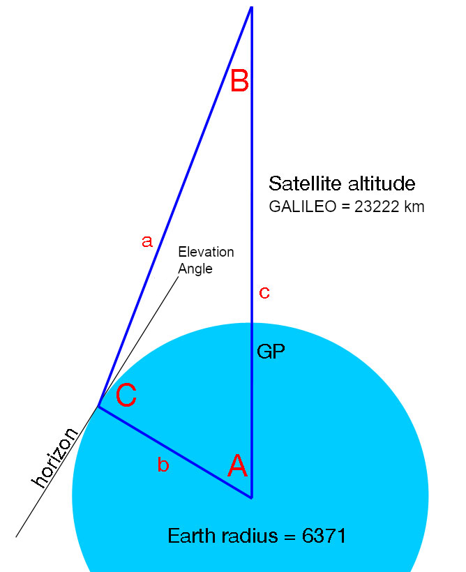

What is the angle of an incoming signal to a SARSAT MEO satellite (known as the nadir angle and measured in degrees from the satellite to the point on earth directly below) if the transmitter's view of the satellite is at 20-degrees elevation above the horizon?
[Note: Updated January 2025: the original analysis used the orbital height of a GPS satellite. A GALILEO satellite is in a slightly higher orbit, 23,222-km compared to 20,180-km. I have re-calculated to use the GALILEO orbit height, and also to use an elevation angle of 20-degrees.)
A sketch shows the relationships, not drawn to scale:
Fig. 1. Geometry of the Nadir Angle
The blue scalene triangle ABC can be solved as follows:
--we know the length of side b; it's the Earth radius; b = 6371-km
--we know angle C; it is the elevation angle, 20-degrees, plus 90-degrees; C = 110-degrees
--we know length of side c; it's the satellite altitude 23222 plus earth radius 6271 km = 29593-km
We can find the other angles and lengths using a relationship known as the law of sines for a triangle. That law says
a/sinA = b/sinB = c/sinC
Solving the the remaining angles and sides gives
A (angular displacement from satellite ground point) = 58.3-degrees
B (the nadir angle) = 11.7-degrees
a (path length) = 26,802-km
Angle B is the desired calculation, the nadir angle which means the angular distance off of boresight to the Earth below. This means the signal from a transmitter that sees the satellite at an elevation above the horizon of 20-degrees will arrive at the satellite at a nadir angle of 11.7-degrees. This is of interest because the receiving antenna on the satellite must provide coverage out to at least 11.7-degrees to be useful for transmitters that see the satellite only 20-degrees above their horizon.

In terms of nomenclature of the triangle in Figure 1 above, angle C is 90-degrees when the elevation angle is 0-degrees. To find the nadir angle B, we solve using inputs
b = 6371 km (Earth radius)
C = 90-degrees (required condition)
c = 29593 km
We then get the following calculated values
B = 12.4 degrees (nadir angle)
a = 28,899 km (path length)
A = 77.6 degrees (angular distance to ground point)

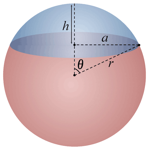

The view of the Earth from the satellite in which it is available at 20-degree elevation or higher projects as a circular area on a sphere. If we assume the ground point (GP) of the satellite is at the north pole of the sphere, this area is known as a spherical cap.
Spherical cap, from a drawing by Jhmadden; used under terms of the Creative Commons Attribution Share Alike 4.0
The area of the spherical cap is defined by
Area = 2πrh
where r is the radius of the sphere and h is the height from the circle's center to the pole. A hemisphere is a special case of spherical cap where h = r.

The height h can be calculated with right-triangle geometry; we use the right-triangle with hypotenuse r and angle θ, which will be A (from the diagram in Figure 1), or in this case 58.3-degrees. Because the sum of angles must be 180, the other angle must then be
h1 = 180 - 90 - 58.3 = 31.7-degree.
The length of the side opposite that angle h1 is then equal to
sin(31.7) x 6371 = 3348-km
The length of the side opposite the 31.7-degree angle h1 is equal to (r-h), or in other words h + h1 =r. This means h = r - h1:
h = 6371 - 3348 = 3023-km

The area of the spherical cap can also be calculated from
Area = 2πr2(1−cosθ)
which avoids having to find h. This method gives the area as
Area = 121,020,026 km2
This value is only 0.007-percent different from the value calculated using the other method, and that is probably due to some rounding of the factors employed in the first calculation.

Reworking the problem for a SARSAT satellite in low earth orbit (LEO) and allowing for a minimum elevation angle of 15-degrees (a more practical situation) we find the following:
For a satellite altitude of 850 km, Earth radius 6371 km, and elevation angle 15-degrees, our ABC triangle has
C = 90 + 15 = 105
c = 7221
b = 6371
Solving for B
B = arcSin [(6371sinC)/7221] = 58.454
Solving for A
A = 180 - B - C = 16.545

Revisiting this article after seven years, I thought it would be interesting to calculate the required elevation angle for an observer at the Earth surface in order for the nadir angle of arrival at the GALILEO satellite to not be greater than 12-degrees. (The 12-degrees figure comes from the plot of the GALILEO SARSAT 406-MHz antenna response in a related discussion.)
Using the handy triangle calculated at
https://www.calculator.net/triangle-calculator.html
makes this quite simple. Using the identifiers as shown above, we enter the values for the triangle as
c = 29593
B = 12
b = 6371
There are two possible solutions, but one of them is not valid in our case because it requires the path to the satellite to pass through the Earth. Discarding that solution we get
a = 27,292-km (path length)
b = 6,371-km (given)
c = 23,222-km (given)
A = 63.0-degrees (angular distance to ground point)
B = 13-degree (given)
C = 105-degrees (from which we get the elevation angle calculated below)
We then solve for the elevation angle as C - 90 = 15-degrees, and a path length of 27,292-km. Now we can go back to the article discussing path length and signal loss to see how this fits into the path signal margin. (Hint: the fade margin works out to be quite impressive.)
