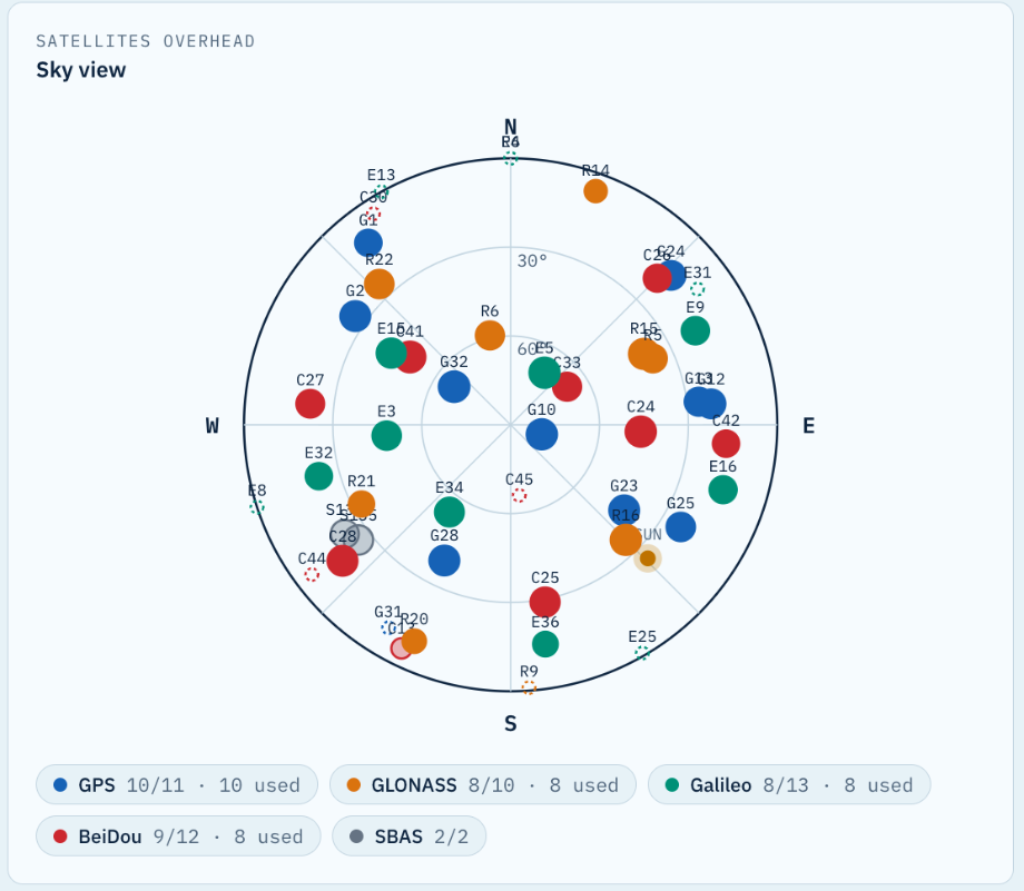

Figure 1 is a screen capture of a polar plot of satellites in view at my location on a recent date. The YIC modern GNSS receiver is tracking 38-satellites. The position fix accuracy for 50-percent CEP is 1-cm or about 1/2-inch.
Fig. 1. Satellites in View polar plot using YIC USB GNSS receiver indoors, with the antenna on a south facing seccond-storey window.
