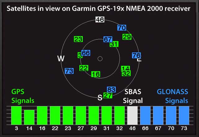

Figure 1 shows a screen capture from a Garmin GPS 19x receiver showing satellites in view with identification numbers. The screen capture deserves a bit of annotation. The polar plot shows elevation and azimuth to three categories of satellites:
--several GPS satellites, shown in GREEN
--an SBAS satellite, shown in WHITE (because it has no psuedo-range used in the position solution)
--several GLONASS satellites, shown in BLUE
Fig. 1. GARMIN Satellites-in-View presentation from their product GPS19x.
The identification numbers are in NMEA format. This means we have to apply a translation to them to figure out the actual space vehicle identifier. That translation results in the following satellites in view:
GPS: PRN 3, 14, 16, 22, 23, 27, 29, 31, 32
SBAS: PRN 133
GLONASS: Slot numbers 2, 3, 6, 9
Translating from NMEA to Satellite ID
The method of translating from a NMEA number to the actual satellite identification number, or vice versa, is not particularly obvious. It relies on an unusual mapping of numbers in the range of 00 to 99 in order to fit into the two-digit space allowed by early NMEA protocol descriptions.
For GPS satellites, the NMEA number translates to space vehicle identifier by the PRN code in use: NMEA = PRN code for a satellite, which can only up to 32. In this instance, the satellites in view from the GPS constellation were PRN 3, 14, 16, 22, 23, 27, 29, 31, and 32.
For SBAS satellites, the NMEA number translates to space vehicle identifier by the PRN code in use: NMEA = (PRN code - 87). To convert back to the PRN number from the NMEA number the relationship is PRN = (NMEA + 87). In this instance, the satellite in view is PRN = 133. This is the WAAS signal from INMARSAT-4F3, located at geostationary orbital slot 98.5-degree West longitude. The position shown in the polar plot is not accurate, that is, the view to this satellite is not due North and on the horizon. I believe Garmin represents the satellite in that incorrect position because in the particular case of PRN 133 the satellite is not sending a ranging signal; it only sends the correction signals. This seems to be a quirk of the Garmin software to show the SBAS satellite on the polar plot in an incorrect location when it is not sending a ranging signal.
For GLONASS satellites, the NMEA number translates to space vehicle identifier by the GLONASS slot number: NMEA = (GLONASS slot number + 64). To convert back to the GLONASS slot number the relationship is then GLONASS slot number = (NMEA - 64). The Garmin is showing NMEA number 66, 67, 70, and 73. These convert to GLONASS slot numbers 2, 3, 6, 9.

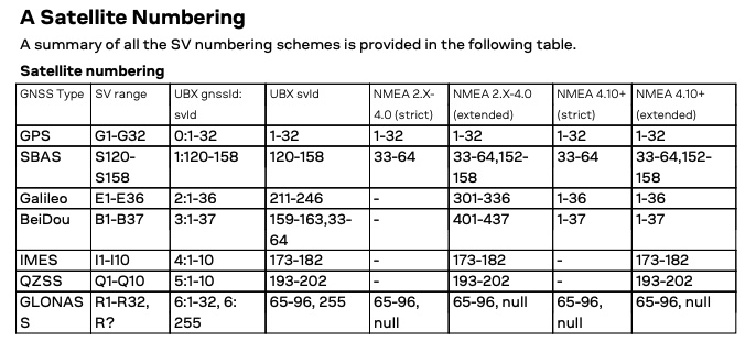

To update this article (now that the European Space Agency's GALILEO GNSS system has been in fullly-operational status for several years and consumer grade GNSS receviers are typically able to use GALILEO) regarding the psuedo-random-noise or PRN (and PRN does not mean pseudo random number) modulation identification number for the GALILEO constellation, the best information I can find is that GALILEO will use E1 through E36, but GNSS receivers reporting those identities using NMEA-0183 and the PRN field may not include the "E".
Cf.: https://www.gpsrchive.com/Shared/Satell ... tification
I also found the table shown below on page 446 in a recent uBlox document at:
https://content.u-blox.com/sites/default/files/products/documents/u-blox8-M8_ReceiverDescrProtSpec_UBX-13003221.pdf
Fig. 2. A table from a uBlox document showing numbering schemes for various version of the NMEA-0183 protocol for satellite identification.
Also, perhaps in NMEA-2000 there is a specified method to identify the satellite constellation, but without the actual NMEA specifications available, to get any useful information about their method is very difficult.
