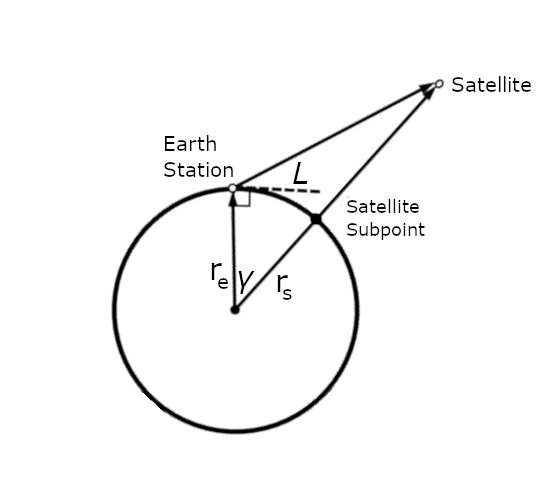

The look angles azimuth and elevation are calculated with spherical trigonometry and involve three-dimension (3D) analysis. The elevation angle can be reduced to a two-dimension (2D) by considering just the triangle formed in the plane of the satellite location, the earth location, and the center of the earth. This plane is shown in Figure 1.
Fig. 1. Angular relationship between satellite location, earth location, and earth center, shown in a 2D plane.
The angle marked γ is usually referred to as "gamma" and shown with the Greek lower case letter γ. This is the included angle in the triangle at the earth center point.
The point marked Satellite Subpoint is the location on the Earth were the satellite appears directly overhead. In this particular case of using a geostationary satellite, the satellite subpoint will be on the equator and at the specific longitude of the satellite position. This will simplify some of the calculations. For non-geostationary satellites, the satellite would appear to be in motion relative to the earth because of its orbital characteristics, and in order to calculate the subpoint the precise orbital elements and the particular time would be required to predict the exactly location of the satellite subpoint. A geostationary satellite appears at a fixed position in the sky, so the time and orbit elements are not needed to deduce its subpoint.
The angle L is the elevation angle at the earth station location, which is the angle to be calculated from the other parameters available.
Two sides of the triangle have known lengths, re and rs, which are the radius of the earth and the radius of the satellite orbit. The radius of the earth is well known, and the radius of the satellite orbit for a geostationary satellite is also well known, so these two elements are easily found.

Note that in the diagram shown in Figure 1, repeated below
the relationship shown in the drawing occurs in a particular situation with a geostationary satellite orbit which happens to be located on your meridian. In that case satellite subpoint on the earth is on the equator, and your subpoint angular distance, the angle γ (gamma), is just your latitude. The triangle can then be solved with 2D geometry to find the elevation angle.

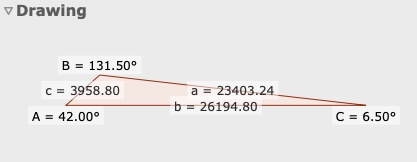

For example, using the sin-cos calculator at
http://cossincalc.com
and using its notation of angles A, B, C and sides a, b ,c:
Enter these values:
A = your latitude
b = satellite radius, equal to earth radius + satellite orbit altutide
c = earth radius
The earth radius is 3,958.8 miles.
For a geostationary orbit the satellite altitude is 22,236 miles, so satellite radius is then 26194.8-miles
Assuming there is a geostationary satellite on your meridian (i.e., at your longitude), then Angle A is your latitude.
For a satellite on your meridian, the included angle B minus 90 is the satellite elevation angle:
The calculator provides this drawing showing the solution:
Fig. 2. A triangle showing the 2D geometry when a satellite in geostationary orbit is on your meridian.
The included angle B is 131.5-degree, so minus 90-degrees gives the elevation angle: 41.5-degrees. The path length to the satellite, side a, is thus 23,403-miles. This is a much longer path length to the WAAS satellites that occurs with the GPS constellation satellites.
