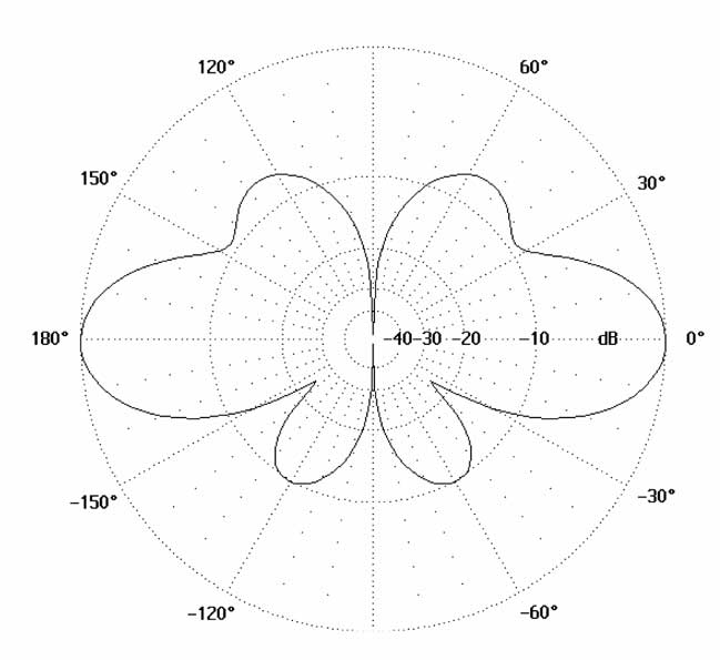

Unusual for marine antennas, COMROD supplies a vertical radiation pattern plot:
Vertical radiation pattern of COMROD AV60BI8
This plot shows an extremely deep null (-40 dB) in the radiation pattern in the collinear directions above and below the antenna. This demonstrates why collinear vertical separation between an antenna and electronic gear or between one antenna from another is so much more effective than horizontal separation. The antenna has extremely reduced radiation in those directions.

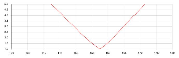

Also unusual, COMROD supplies a VSWR graph. The VHF marine band for ship transmitters is confined to 156 to 157-MHz. In this region the VSWR will be extremely low, close to 1:1. AIS transmitters operate at 162-MHz, where this antenna will have a VSWR of about 2.5:1 or less when measured at the end of a 5-meter transmission line due to some line losses.
VSWR v. Frequency, COMROD AV60BI8 antenna

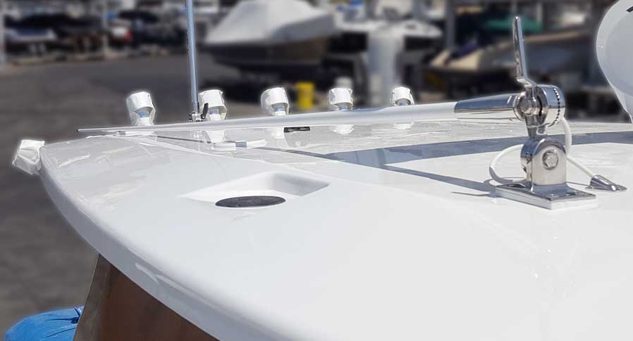

Here are two views of the COMROD antenna installed on a hard top:
COMROD antenna mounted to hardtop. Photo credit Mark Sirof.

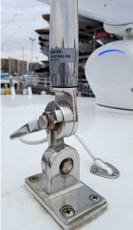

COMROD base with metal ferule. The transmission line connector is inside the base. Photo credit Mark Sirof.

Jim - How does the performance compare to GAM setup?
And, I note that there's a required connection, instead of the antenna being supplied with a certain amount of cable. How much loss, if any would occur because of the connection?

Loss in connectors in transmission lines is negligible assuming good connectors in good condition.
