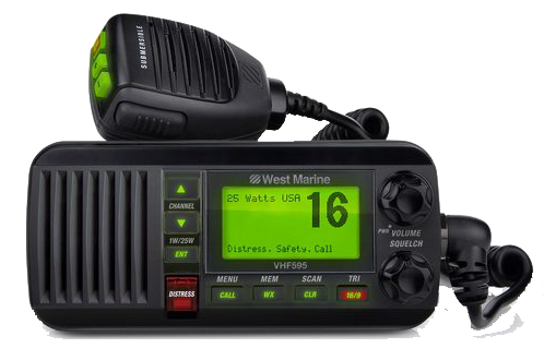

The West Marine VHF595 radio with black case.

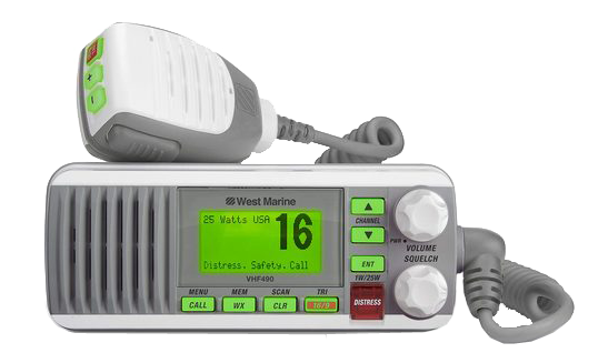

The West Marine VHF490 radio, available only in two-tone gray-white case as shown.

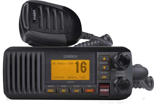

The Uniden UM385 radio in black. Note the difference in the LCD display color and lack of channel changing buttons on the microphone.

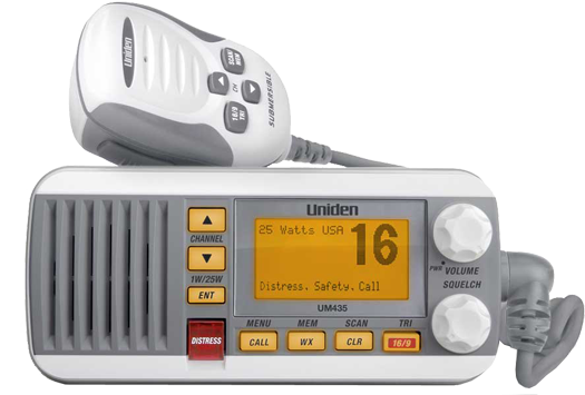

The Uniden UM435 radio in white-gray. Note position of buttons on the microphone.
