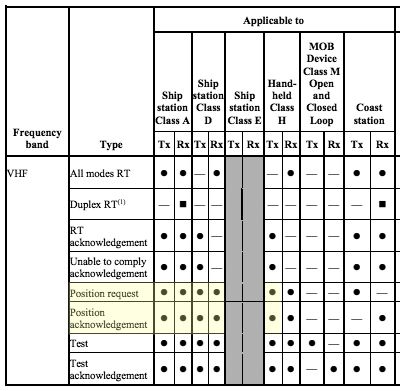

I have browsed the ITU Recommendation R-M.493-15 searching for mention of "Class H". I found that on folio [40] in [TABLE A1-4.7], under the rows ]"Position request" and "Position Acknowledgement"] that the Class-H device [and CLASS-D device] [is required] to perform those DSC functions.
Excerpt from Rec. ITU-R M.493-15, Table A1-4.7, Urgency and safety – Individual calls and their acknowledgements, VHF DSC radios. Class-D and Class-H highlighted in yellow.
[Illustrated added to original article--jimh]
[As seen above, position request and position acknowledgement are] mandatory behaviors for either Class-D or Class-H DSC VHF Marine Band radios.
As for Standard-Horizon not including the function to make a position request in their model HX-890, I can only guess [it was an oversight].
