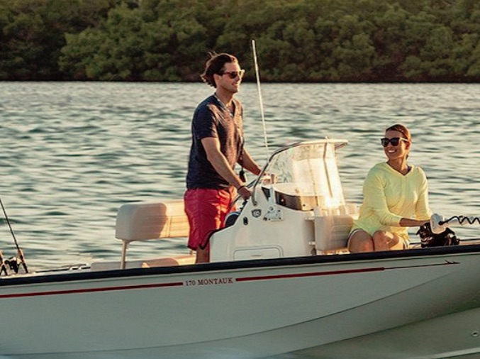

Boston Whaler offers 170 MONTAUK customers the option of having a VHF Marine Band radio and antenna pre-installed. From their website I found several images showing the antenna location. Figure 1 below demonstrates the position very clearly. A short, three-foot antenna is mounted to the Starboard side of the helm console, and the antenna appears to have an insulating radome covering the radiating element.
Fig. 1. VHF antenna location on 170 MONTAUK as installed at the factory. Note the absence of any rigging for a Bimini top on this boat. The presence of a trolling motor and fishing rods suggests this boat was intended for angling.
For me there are several problems with the antenna location as illustrated above. My concerns are in two realms: the antenna location as it relates to the operation of the radio, and the antenna location as it relates to the operation of the boat.
With regard to the radio operation aspect of the antenna location, I see these problems:
  • the vertical separation between the antenna and the transmitter is nil; most manufacturers want three-feet of separation, and the vertical separation is the most important.
  • the radiating portion of the antenna is very close to the helmsman; at 25-Watt power level the helmsman's eyes are looking right at the radiation source
  • the metal frame of the windshield railing is very close to the antenna radiating element, and that is a fundamental no-no.
With regard to the boat operation aspect, I see these problems:
  • the boat as shown has no weather canvas, that is, no Bimini top, and the antenna as mounted appears to interfere with a Bimini top, which is probably why none was installed on the boat in shown in Figure 1;
  • the antenna cannot be folded down to horizontal, as it would create an obstruction to movement in the boat, nor can the antenna be folded 180-degree as there is insufficient clearance, and thus whenever the boat is in operation the antenna must be moved into its operating position;
  • the antenna presents a potential hand held or grab rail for anyone to inadvertently grab onto, and the radiating element most likely lacks sufficient strength and could be broken off by someone grabbing for it in rough seas.
These problems are not unique to the 170 MONTAUK boat, but I believe that the Unibond hull construction contributes to the console-mounted antenna base as being perhaps the most practical method of installation, although not the most practical method for overall best radio performance and best operation of the boat.

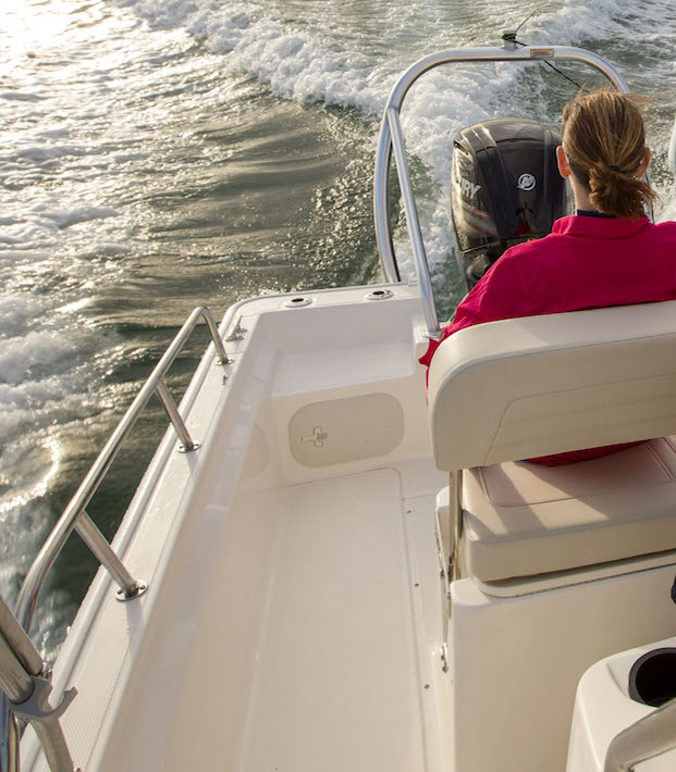

Fig. 2. View of cockpit inwale of 170 MONTAUK as potential antenna base mounting location.
Based on what can be seen in Figure 2, the antenna base would be mounted slightly forward of the aft-most vertical rail of the side rails. The transmission line could be routed into the compartment below the stern quarter seat, and from there should have access to the rigging tunnel. I would expect that the typically transmission line length provided with the antenna would be 15-feet, and that length should be sufficient to allow reaching to the radio at the console via the rigging tunnel. Because the mount cannot be through-bolted, the location should try to take advantage of any embedded reinforcement material below the laminate in this general area. If there are not embedded reinforcements, the load of the base should be spread using a base plate that enlarges the area of contact between the ratchet-mount and the laminate surface. Again, this may have to be resolved on location.
