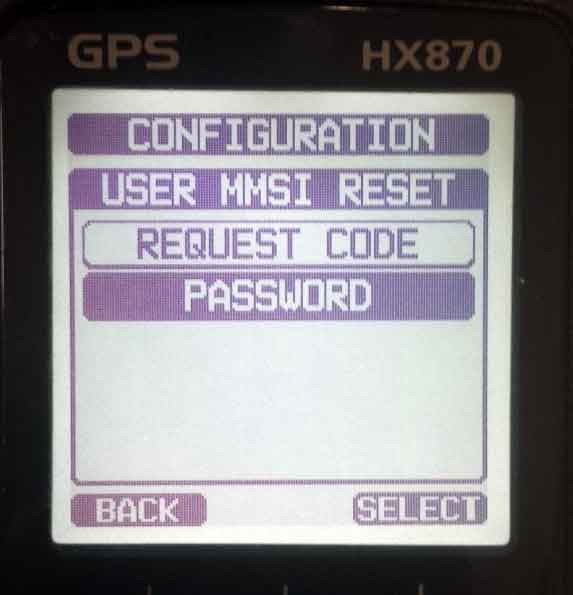

In the specific instance of the Standard-Horizon HX870 DSC handheld radio, the MMSI reset process works as follows:
--the radio must have a recent version of firmware; firmware version v2.03 or higher will allow the user to perform the rest of the procedure

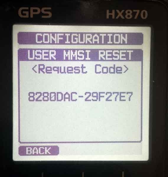

--the user extracts from the radio's user interface a value for a key called the USER MMSI RESET CODE
--the user sends an email to the manufacturer's technical support with the following information: user's full name; radio serial number; present MMSI; new MMSI to be installed; and USER MMSI RESET CODE

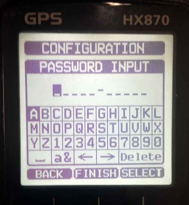

--the manufacturer replies by providing the user with a PASSWORD key
--using the supplied PASSWORD key, the user can then change the MMSI to the new value

The screen captures below illustrate the user interface screens that select the option, generate the MMSI reset code, and provide for password entry:
