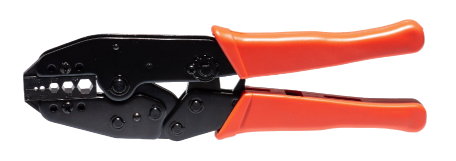

The FME cable-end connectors are all designed for installation with crimp tools. The recommended hexagonal crimp diameters are 0.068-inch and 0.213-inch. The recommended crimp tool is Amphenol part number 47-10070. Mouser stocks this tool as their part number 523-47-10070 at about $115.
All three element of this connector system, the cable end connector, the FME to UHF adapter, and the Hex Sizes: .068, .100, .213, .256, .324 crimp tool, are also available from alternate suppliers such as SHOWMECABLES.COM in Missouri (to which hyperlinks are given in the preceding text). Again, the most expensive element is the crimp tool, but at about half the price of the Amphenol-brand, the $43 no-brand crimp tool may be a tolerable expense for some boaters.
Fig. 3. A no-brand $43 crimp tool from ShowMeCables.
