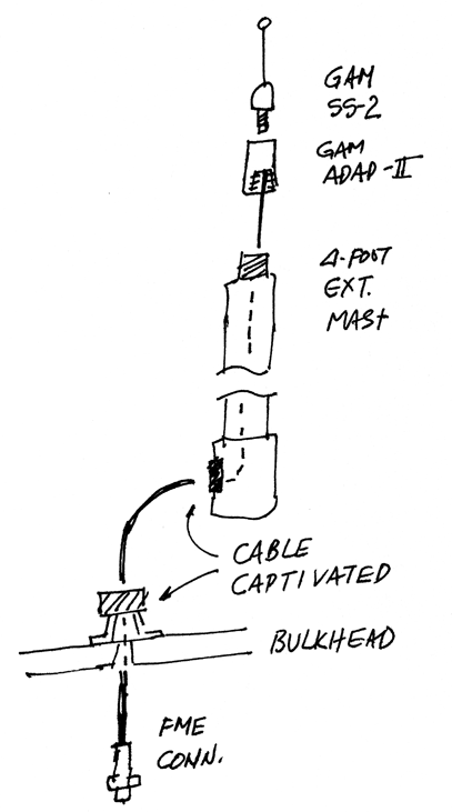

As seen in the sketch below (Figure 1), in order to remove the damaged extension mast from the antenna mounting, the FME connector had to be cut off so that the bare cable could be pulled out of the boat and eventually out of the extension mast, after the mast was disconnected from the mount.
Fig. 1. The path of the antenna transmission line cable passed through two captivating locations, the extension mast and the cabin bulkhead. Although the FME connector needs only a 3/8-inch diameter hole to pass through, the holes in the extension mast and the bulkhead fitting were too small.

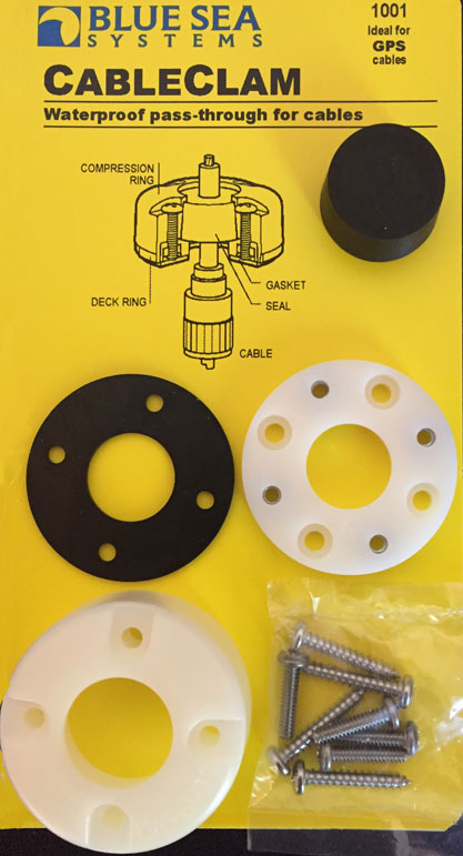

BLUE SEA SYSTEMS has a line of fittings for passing a cable through a bulkhead and maintaining a weather-tight seal. They call their product a "Cable Clam." They offer these in a range of sizes. There are two controlling dimensions, the size of the circular backplate (deck ring) that holds the assembly to the bulkhead, and the size of the hole in that backplate that will limit the diameter of the hole in the bulkhead. The smallest model is the 1001. The circular assembly has a diameter of 1.85-inches, and there is a center hole with a diameter of 0.79-inch. The center hole at 0.79 inch will be large enough to permit a PL-259 connector to pass through. There is a compression ring with a somewhat larger center hole, and the cable and connector must be passed through this hole, as well.
FIg. 2. Blue Sea System Cable Clam model 1001. This product retails for about $18. It includes the four machine screws and four self-tapping screws shown.
The black circular plug seen on the upper right in Figure 2 is a slightly tapered conical section rubber seal for the cable to pass through. During installation, the installer must drill a center hole in this plug that is appropriate for the diameter of the cable. Then the installer cuts a slit in the plug from the center hole to the outer rim, so that the seal may be slipped over the cable.
In assembly of the cable clam, the cable and connector are first passed through the compression ring, then though the deck ring, and though the hole in the bulkhead. Then the seal is slipped onto the cable, and the compression ring tightened down onto the deck ring to complete the seal and installation.
For my installation with an FME female cable-end connector on RG-58C/U transmission line, only a 3/8-inch hole will be necessary in the bulkhead. The original 1/4-inch hole in the bulkhead will be enlarged to 3/8-inch, and the 1.8-inch diameter deck ring will nicely cover the old mounting holes for the original and much smaller bulkhead fitting.
Blue Sea Systems also refers to the model 1001 as having a maximum cable size of 0.68-inch. I believe this refers to the maximum diameter of a hole that can be made in the seal plug by drilling. For drilling the center hole in the seal, I plan to temporarily install the seal in place under the compression ring, and drill the hole in the seal while it is on the boat bulkhead. I have not yet installed the cable clam. I will remark on the actual installation process in a future update.

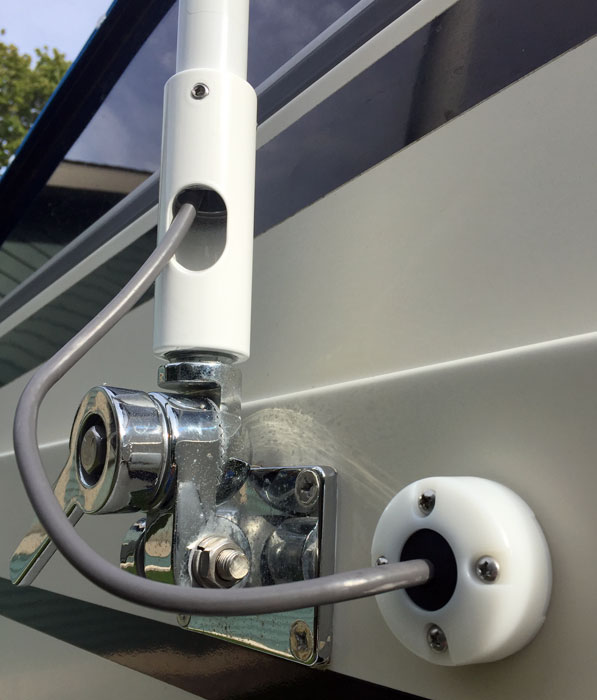

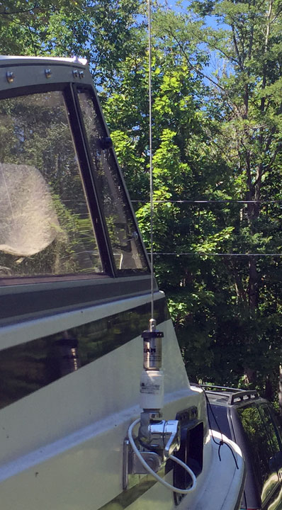

Before I could replace the extension mast and fix the captivated cable problems, I need to get something working for the boat radio. I installed the GAM SS-2 antenna on its ADAP-II mount and put it directly on the base hinged mount, without an extension mast. I had to run the transmission line through a small hole in the base mount. This hole was located on the inboard side of the mount, so it created a tight bend in the transmission line because of the close clearance to the cabin superstructure. And the antenna was mounted very low, so the radiating element was right next to all the helm electronics. Getting the antenna radiator away from the instrument panel was one of the original objectives for using the GAM SS-2 with an elevated mounting on an extension mast. I knew this mount was only going to be temporary.
Fig. 3. The GAM SS-2 antenna on the ADAP-II mount with feedline exiting at the bottom, running through the hinge mount and exiting on the inboard side.

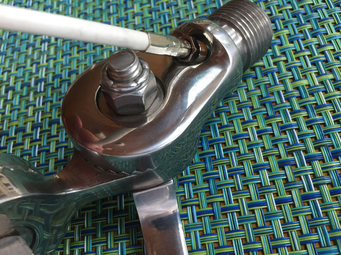

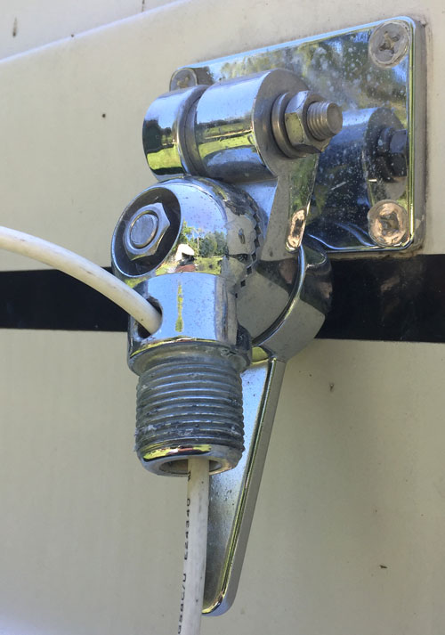

Feeding the transmission line cable through the hinge mount base hole was impossible with the mount in its normal orientation. Even with the mount re-positioned to let gravity help, getting the cable through it was tedious.
Fig. 4. The hinge base cable exit hole was oriented inboard in the normal position of the mount. Here I have loosened the mount to make it much easier to thread the cable through. I vowed never to do this again.

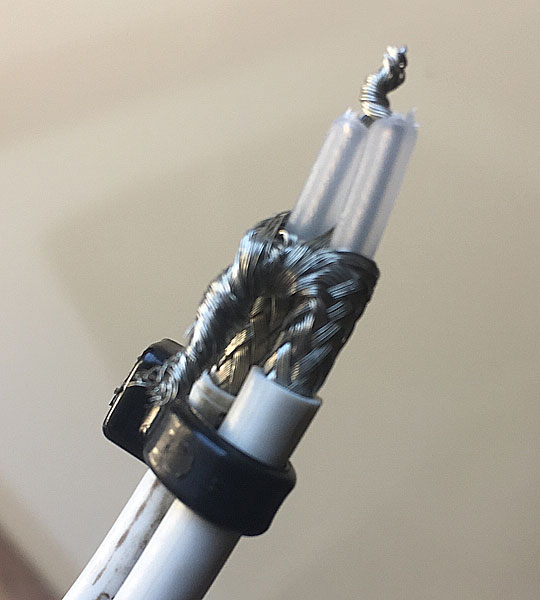

A further problem was the transmission line had to be run through both the mount and the bulkhead without a connector. I did not feel like putting on a connector that I knew I would be cutting off in a week or two, so I made a very temporary splice in the coaxial transmission line.
Fig. 5. A very temporary splice in the transmission line; no solder was used.
The boat VHF Marine Band radio was quite pleased to transmit and receive through that rather crude splice for the couple of hours we had the boat underway and used the temporary antenna. A splice like the one shown is certainly not suitable for a long-term solution, but it worked well as a temporary fix.
Mounting the antenna this low convinced me that using an extension mast was mandatory. I was also reminded how awkward it was to have to use the screw-on antenna adaptor and wind up 14 or more revolutions onto the transmission line in the process. I set about to eliminate both these problems.

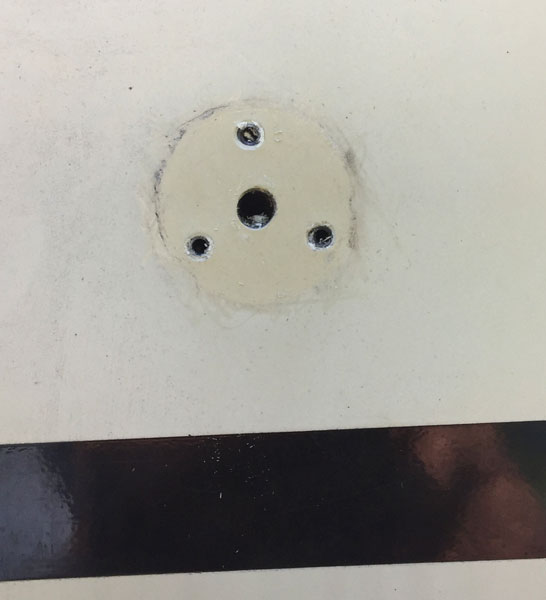

The first step was to remove the existing cable pass-through fitting. Its three #6 mounting screws came out easily, but the fitting was very firmly adhered to the cabin superstructure gel coat. I put pliers on it and tried to give it a twist--nothing doing with that method. Finally I got a chisel and hammer. With the steel chisel blade right at the joint line between metal and gel coat, I gave a whack with the hammer. That did it; the fitting was loose.
My guess is the original installer did not use a sealant but perhaps used a marine sealer-adhesive product like 3M4200 or (God forbid) 3M5200. Those products are very strong adhesives. I made a plastic scraper out of a throwaway plastic knife from some take-out food, and used this scraper to remove the remaining sealant-adhesive.
The sealant had made a very good weather seal because underneath was pure unweathered 28-year-old Boston Whaler Desert Tan gelcoat, which stood in contrast to the surrounding gel coat surfaces, which--admittedly--were quite neglected.
Fig. 6. The original gel coat color now seeing sunlight for the first time in perhaps in 30-years.

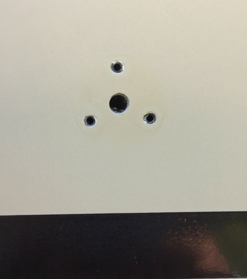

This color mismatch was so stunning that I had to immediately fix it. I cleaned off the just-developing mildew and dirt, and I wet-sanded with 600-grit to get rid of the oxidation of the gel coat surface. As usually happens, the Boston Whaler gel coat returned to new appearance--at least while wet.
Fig. 7. The gel coat after cleaning and wet sanding.

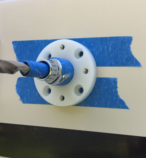

I wanted to reuse the existing center hole and also cover the existing but now unused original three screw holes. The existing center hole was 0.25-inch diameter. I enlarged the center hole of 0.375-inch, then to help center the new base ring of the Cable Clam, I used a 0.375-inch drill stuck into the existing hole and turned a small socket into a flange, making my own alignment fixture.
Fig. 8. An alignment fixture made from a drill bit, a socket, and some blue tape.
After carefully marking the holes onto the blue tape, I removed the base ring and drilled the first hole. This hole needs to be right on the money--I did my best. As always when drilling into 28-year-old brittle gel coat for a screw fastener hole, the top layer of the boat hull, the gel coat layer, must be enlarged in diameter so the screw fastener is not trying to cut threads into it. If the gel coat is not enlarged it will almost always crack when a screw is forced through it.
I reinstalled the deck ring and one mounting screw to fix it in position. To drill the remaining three holes I used a drill with the same diameter as the mounting holes on the deck ring to mark the center of the hole. Then a smaller drill made the through-hole guided by the indentation of the larger hole. Then I carefully enlarged the gel coat at the top of the screw hole, and also slightly enlarged the hole itself so the self-tapping screw threads were cutting away just the a minimal amount of larger hole diameter.

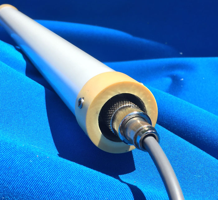

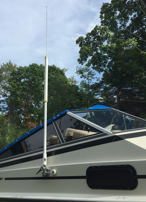

With the old antenna and extension mast set aside, I turned to a new antenna project: installing a MORAD VHF-156 HD antenna. This new antenna system was going to be built so there were no threaded connections between the antenna and the extension mast, and there would be plenty of room for the transmission line and connector to pass through the extension mast, the base mount, and the cabin bulkhead.
The new antenna system consists of these MORAD components:
The mechanical assembly of this system has only one threaded component: the M87 base threads onto the standard 1 x14 threaded ratchet hinge mount. You can install the M87 based onto the mount, and then build the rest of the antenna without having to screw-on any other component. The base is 4-inches long, so it adds some height to the system
The V2 extension is 2-feet long. It is just a nicely fabricated piece of aluminum tubing with an excellent white paint finish. The bottom end fits into a socket on the M87 mount. Three set screws are tightened to hold the V2 mast to the M87 mount. At the upper end of the V2, the VHF-156HD antenna fits over the mast, and three set screws hold the antenna in place. Use of a thread locker on the set screws is recommended. Use Loctite 222 High-Temp, Low-Strength Purple PN: 38653-555339.
Fig. 10. The recessed UHF-series antenna connector on the MORAD VHF-156HD antenna with transmission line connected.
Fig. 11. The MORAD M87 mount adaptor with V2 extension mast. The RG-8X transmission line exits via the generously large hole in the mount adaptor and passes through the Blue Sea Systems Cable Clam.
Fig. 12. The MORAD VHF-156HD antenna installed, showing overall height in operating position.
