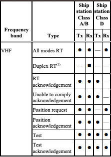

In ITU recommendation M.493-13 that was approved in 2009, a DSC VHF Class-D radio was NOT required to handle either reception or transmission of POSITION REQUEST or POSITION ACKNOWLEDGEMENT calls. (This is the current FCC mandated compliance in the USA for DSC Class-D radios. See below.)
In ITU recommendation M.493-14 that was approved in 2015, a DSC VHF Class-D radio is require to be able to RECEIVE an INDIVIDUAL call of type SAFETY and of category SAFETY or URGENCY for a POSITION REQUEST.
A DSC VHF Class-D radio is required to be able to TRANSMIT an INDIVIDUAL call of type SAFETY and of category SAFETY or URGENCY as a POSITION ACKNOWLEDGEMENT
The logic behind this is for the radio to be able to send its position in reply to a request for position, and that this behavior should be set to AUTOMATIC following a DISTRESS ALERT CALL being transmitted so the rescuers can get an updated position. However, the operator can suppress the automatic POSITION ACKNOWLEDGEMENT transmission to maintain privacy if there has not been a DISTRESS ALERT sent.
From R-REC-M.493-14 Table A1-4.7
Cf.: https://www.itu.int/dms_pubrec/itu-r/re ... !PDF-E.pdf
at Table A1-4.7

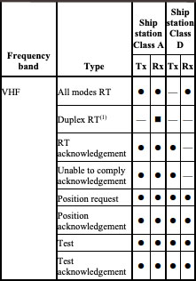

In ITU recommendation M.493-15, the latest version and approved in January 2019 and in effect perhaps in other maritime countries, a DSC VHF Class-D radio is required to both RECEIVE and TRANSMIT an INDIVIDUAL call of type SAFETY of category SAFETY or URGENCY for POSITION REQUEST (from or to another individual vessel) and to both RECEIVE and TRANSMIT a POSITION ACKNOWLEDGEMENT (from or to another individual vessel).
From R-REC-M.493-15 Table A1-4.7
The behavior that a Class-D SC radio can also TRANSMIT an INDIVIDUAL call of type SAFETY of category SAFETY or URGENCY for POSITION REQUEST (to another individual vessel) and RECEIVE a POSITION ACKNOWLEDGEMENT (from another individual vessel) was available in many VHF DSC Class-D radios prior to that behavior being mandatory in the ITU recommendations. In the USA at the moment, the official mandatory behavior is still stuck at the -13 revision, which requires no position reporting or position requesting.
