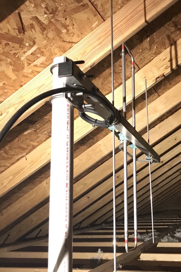

I recently installed a three-element low-noise loop-fed vertically-polarized Yagi antenna at my cabin in Northport. The antenna is oriented with its main lobe pointing due East, and it is located in the attic, about 35-feet above the level of Lake Michigan at the shoreline. I bought this antenna several years ago to use at my home about 20-miles from the Detroit River to listen to AIS transmissions from ships in the river. The antenna was no longer in use for that purpose, so I decided it would better serve me in the Summer in northern Michigan.
The antenna is optimized for 162-MHz for AIS reception, but this works very well for NOAA Weather Radio reception, too. The driven element of the Yagi is a loop. This tends to reduce electrical noise getting into the antenna by eliminating the high impedance of the ends of a conventional Yagi element. Away from the resonant frequency, the loop element works more like a dead short across the antenna transmission line than as an antenna.
The gain of the antenna is probably in the region of 5-deciBel compared to a dipole. In VHF Marine Band antenna terminology 9-deciBel gain.
To preserve signals, the transmission line from antenna to receiver is 55-feet of Times Microwave LMR-240UF cable. The estimated loss in the transmission line at 150-Mhz is about -2 dB. This transmission line cost about $100 with the necessary connector costs and shipping cost from the vendor.
The VHF Marine Band Yagi antenna joins two other antennas in the attic: a long UHF Yagi television broadcast band antenna and a dipole antenna for the FM Broadcast band. Without those two antennas television and FM broadcast reception would be impossible at my location.
The receiver is an older Standard-Horizon GX1500 VHF Marine Band radio, now relegated to a monitoring radio for VHF Marine Band and NOAA Weather Radio reception.

Figure 1 shows the antenna as installed.
Fig. 1. A three-element loop-fed Yagi antenna as installed in the attic.
The antenna was made for me by G0KSC in the United Kingdom as a bespoke design for 162-MHz. The antenna is mounted to 1-1/2-inch PVC pipe. The pipe is secured to the rafters with conduit clamps.
The large coaxial cable transmission line seen is RG-214A/U, a Military Specification double-shielded premium coaxial cable which is attached to the antenna terminals and also formed into a three-turn choke balun. There is an N-series male connector just out of frame. The transmission line then connects to a N-series female cable jack on the LMR-240UF transmission line. I had to use a smaller diameter cable in order to fit the transmission line into the existing one-inch conduit from the attic to the basement. There were already two runs of RG-6/U cable in the conduit, and the RG-214 was too large to be added to the conduit.
Actually, pulling the LMR240 through the crowded conduit was a chore. The outer vinyl jacket of LMR240 has a rubbery or sticky finish, and pulling that cable through the crowded conduit needed much greater force than anticipated. I should have used more liquid synthetic wax as the wire lubricant.
Working in the attic space during the Summer was not pleasant. Even though the outdoor ambient temperature was in the low 70-degree-range, the temperature in the attic felt like it was over 100-degrees. I won't be doing any tweaking on the antenna until the Fall, when the outdoor air temperature is more like 50-degrees.
