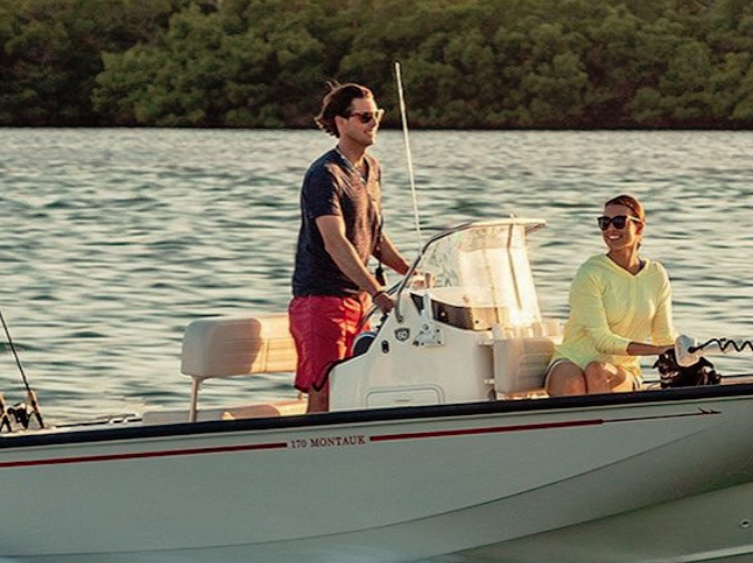

Boston Whaler offers 170 MONTAUK customers the option of having a VHF Marine Band radio and antenna pre-installed. From their website I found several images showing the antenna location. Figure 1 below demonstrates the position very clearly. A short, three-foot antenna is mounted to the Starboard side of the helm console, and the antenna appears to have an insulating radome covering the radiating element.
Fig. 1. VHF antenna location on 170 MONTAUK as installed at the factory. Note the absence of any rigging for a Bimini top on this boat. The presence of a trolling motor and fishing rods suggests this boat was intended for angling.
For me there are several problems with the antenna location as illustrated above. My concerns are in two realms: the antenna location as it relates to the operation of the radio, and the antenna location as it relates to the operation of the boat.
With regard to the radio operation aspect of the antenna location, I see these problems:
  • the vertical separation between the antenna and the transmitter is nil; most manufacturers want three-feet of separation, and the vertical separation is the most important.
  • the radiating portion of the antenna is very close to the helmsman; at 25-Watt power level the helmsman's eyes are looking right at the radiation source
  • the metal frame of the windshield railing is very close to the antenna radiating element, and that is a fundamental no-no.
With regard to the boat operation aspect, I see these problems:
  • the boat as shown has no weather canvas, that is, no Bimini top, and the antenna as mounted appears to interfere with a Bimini top, which is probably why none was installed on the boat in shown in Figure 1;
  • the antenna cannot be folded down to horizontal, as it would create an obstruction to movement in the boat, nor can the antenna be folded 180-degree as there is insufficient clearance, and thus whenever the boat is in operation the antenna must be moved into its operating position;
  • the antenna presents a potential hand held or grab rail for anyone to inadvertently grab onto, and the radiating element most likely lacks sufficient strength and could be broken off by someone grabbing for it in rough seas.
These problems are not unique to the 170 MONTAUK boat, but I believe that the Unibond hull construction contributes to the console-mounted antenna base as being perhaps the most practical method of installation, although not the most practical method for overall best radio performance and best operation of the boat.

On our previously owned 190 Montauk the VHF antenna mount was in about the same location [as shown above in Figure 1]. However, our antenna was mounted to the top of a Shakespeare extension mast. The antenna was a Digital 3-foot stainless steel model. Performance was exceptional. We did not have a Bimini top on the boat as it was used primarily for angling. When towing the boat the mast folded down to rest on the top of the RPS back cushion. The metal antenna could be removed by a push-and-twist for storage. The folded position also allowed for easy installation of the boat cover without interference.

Jefecinco wrote:On our previously owned 190 Montauk the VHF antenna mount was in about the same location [as shown above in Figure 1]...[atop an] extension mast....We did not have a Bimini top on the boat as it was used primarily for angling.
As mentioned in the initial article, mounting the antenna base to the console and using an extension mast to raise the antenna is a good solution as long as the boat will never have any sort of overhead canvas top.
