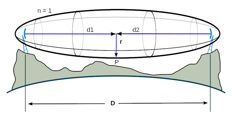

A further consideration in calculating a useable radio path is to consider the absence of possible deflecting surfaces in the path which could redirect a portion of the transmitted wavefront, a wave that would normally not arrive at the receiving antenna, and cause that wave to be directed toward the receiving antenna. A wave arriving at the receiving antenna via deflection will always have travelled a longer distance, so the phase of that waves will not be in synchronism with the direct wave. Depending on the phase relationship between the direct and deflected wave, the two waves can combine either to add or subtract in amplitude. The worst case for combining of the two waves occurs when the longer wave has travelled exactly one-half-wavelength further; when this occurs the two waves will tend to sum toward zero, resulting in a significant reduction the received signal strength.
In order to avoid the possibility of this cancellation of the wavefronts occurring, the path between the transmitting antenna and the receiving must be clear of any obstacles in the regions where the deflected wave would tend to travel a distance that is exactly one-half-wavelength longer. This region is known as the First Fresnel Zone.
The width of the Fresnel Zone between two antenna locations as viewed in the vertical plane is an elongated oval, with the maximum width occurring at the half-way point between the two antennas. This is shown in the illustration below.
Fig. 1. The First Fresnel Zone indicated by the dark black line. Note the radius is greatest at the midpoint of the distance separating the two antennas. Credit: Jcmcclurg, as seen at https://commons.wikimedia.org/wiki/File:FresnelSVG1.svg
Any obstructions that lie inside the Fresnel Zone could generate deflected signals that would arrive out-of-phase with the direct signal, causing the received signal to decrease.
If a path is analyzed and no obstructions are found inside the First Fresnel Zone, the path is generally considered to be a Line-of-Sight (LOS) path, and path loss can be calculated using the Friis equation. (The Friis equation is explained in the addendum of a separate article) If an obstruction penetrates less than the 50-percent into of the First Fresnel Zone is path can be considered as near-Line-of-Sight (nLOS). If an obstruction penetrates more than 50-percent into the First Fresnel Zone, the path is considered as Non-Line-of-Sight (NLOS).

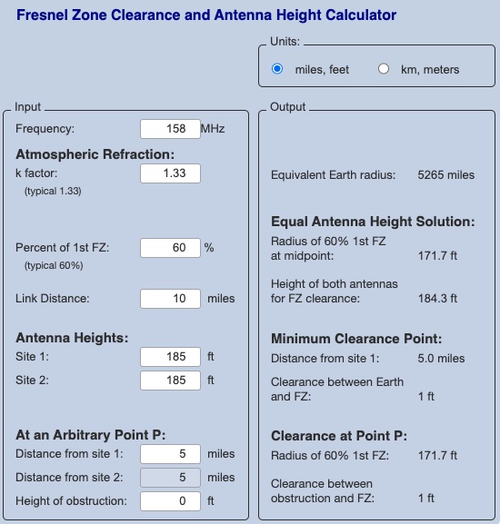

There are a number of useful on-line calculators that predict the necessary clearance above an obstruction that should be maintained at the path midpoint. A good example is found at
Fresnel Zone Calculator
https://afar.net/fresnel-zone-calculator/
That calculator includes an allowance for the natural refraction of the radio wave in the atmosphere. The K-value of 1.33 is the same as the often seen "four-thirds (4/3) Earth radius" factor applied to mapping of Earth curvature between two points for analysis of radio wave propagation. The value of "Percent of 1st FZ" refers to how much of the First Fresnel Zone is kept clear; the value of 60-percent is a common benchmark for assessing the path to he a line-of-sight path.
Using the AFAR.NET calculator for a situation in marine communication in the VHF Marine Band between two boats separated by a distance of just ten miles, as inputs, and setting the amount of clear Fresnel zone desired to be 60-percent (chosen to get the equivalent of a LOS path), the results are rather alarming: the needed antenna height at each end of the path is a very surprising (and generally unobtainable) 185-feet.
Fig. 2. A Fresnel Zone calculator predicting needed antenna height above the sea for a 10-mile path at 158-MHz. From https://afar.net/fresnel-zone-calculator/
This is a good example of why most boat-to-boat VHF Marine Band paths will not be in the category of line-of-sight, and the free-space path loss prediction formula won't be a good model to calculate path loss. Generally the compensation for path loss due to distance must be significanly increased to account for the presence of terrain (or in this case the open sea).
