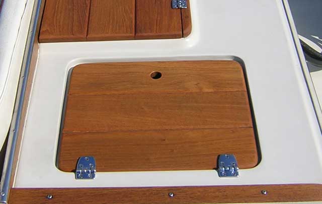

Another simple approach for using wood effectively would be to replace any molded fiberglass hatch covers with wood ones.
Fig. 1. Wooden hatch covers on the aft deck of a 1990 REVENGE 22 W-T Whaler Drive,
along with a wood accent that covers a joint line between molded sections.
