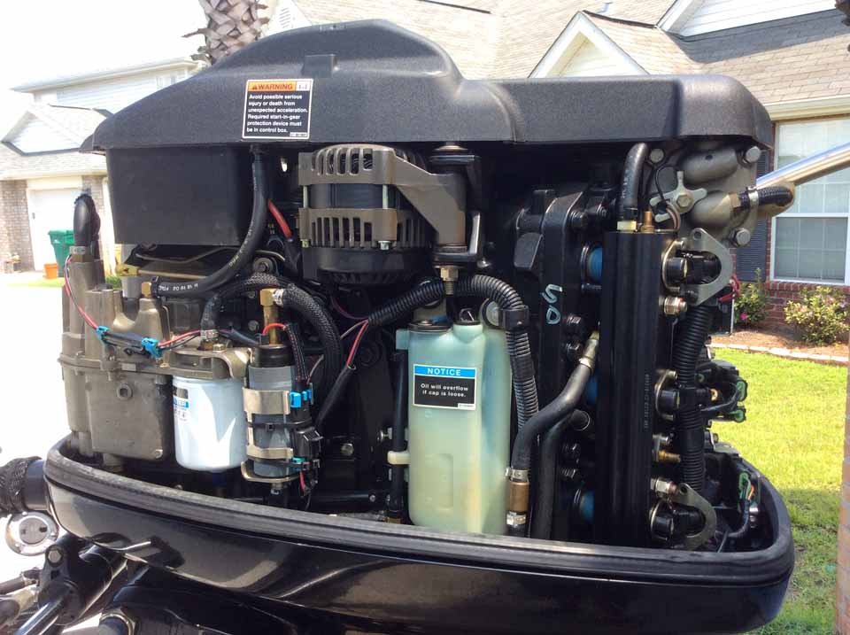

I took [a] first [look] at a [used] Boston Whaler 2005 Nantucket that has been always covered, has all original 2005 equipment, and has an Optimax 150.
The VHF radio is in poor condition.
The original stereo works but not outstanding.
[The c.2005 Mercury OptiMax] engine started right up and purred smoothly. [The engine running time is represented as being] 178 hours.
The hull really shows no spider webbing and is in good repair, [but there is] one bad scrape in the V-hull.

[The NANTUCKET model in general] is a great hull, is very seaworthy, and a price of $20,000 is not bad if the engine checks out--but 178-hours running time seems very low for a 12-year-old boat.
Where has the boat been used? Freshwater? Or saltwater?
If you are serious about buying it, get the engine checked out by a Mercury mechanic that you pick.
It looks like the last oil change was done two years ago.
A sea trial will allow you to see what the engine speed maximum is at wide open throttle and make sure [that the speed obtained is] within specification.
Since that hull is still being produced as the 190 Outrage, all parts are readily available through Whaler.
Don't ponder too long or it will get snatched up from under your nose.
That gash at the bottom needs to be checked out to make sure it does not go too deeply into the fiberglass. If [the damage] is just [confined to] the gelcoat, it can be repaired easily.
Make sure to check the navigating lighting. [On] my boat [the navigation lamp sockets] need to be dabbed with dielectric grease every season.

Mercury Mechanic to check it for you. These [older Mercury OptiMax engines] were in the first wave of direct injection oil into cylinders--[high technology]. There are a lot of great stories of that generation Mercury engine. There are some others, also.
Begin with a check book at a good dealer.
While you are at it, price a new 150 [HP outboard engine] just so you know the whole picture.

A short history of the Mercury outboard engines sold under the branding of OptiMax:
Mercury developed their two-stroke low-emission outboard engines by licensing the basic technology from the Orbital company of Australia, who invented the two-cycle-power-stroke direct-fuel injection technology, patented it, and offered licensing for its use. The principal distinction of the Orbital Combustion Process--the actual technology used in OptiMax--was that the fuel would be mixed with pressurized air and then the fuel-air mixture injected into the cylinder.
This unusual technology had only been used in lower-power and simpler engines, but Mercury scaled it up to engines with as much as 300-HP, or even more in some race-only engines.
The adoption of the Orbital Combustion Process in the form of the Mercury OptiMax was motivated by federal regulations requiring spark-ignition internal combustion engines, including marine engines, to reduce their exhaust gas emission by 80-percent over a ten year period of phasing in stricter emission regulations.
The first generation of the Mercury OptiMax had rather widely known and somewhat embarrassing problems in production and in operation by consumers. Reliability became so poor that Mercury took the rather unusual step of halting all production of the engine for a few months to sort out the problems and come up with solutions. The problems seemed to occur mostly in the larger displacement V6 engines, typically 200-HP and higher.
With Boston Whaler under ownership of Brunswick, the Boston Whaler boats began a gradual evolution to being pre-rigged and sold ONLY with Mercury-branded outboard engines. Thus Boston Whaler boats began to be sold with Mercury OptiMax engines.
As problems with OptiMax engines became more well-known and widespread, customers of Boston Whaler began to order boats with four-stroke-power-cycle engines instead of the OptiMax engines, and, over a few years, orders for boats with OptiMax became so few that Boston Whaler dropped the OptiMax engine as a power choice and by c.2007 the OptiMax was no longer offered with Boston Whaler boats.
To be fair, some--but certainly not all--of the problems encountered with the OptiMax engine in the field were due to poor installations, failure to follow mandatory procedures, and poor choice of oils to use with them. Chronic problems with spark plug fouling have sometimes been said to be caused by use of improper oils. It is often recommended to use only the specialty Mercury-branded oil recommended, which is priced much more than generic TCW-III oils.
Mercury tried to revive the OptiMax brand name by announcing a new generation, which for a brief time they called OptiMax The Next Generation (OTNG). That branding did not last very long, and the actual physical changes were rather few, particularly on the smaller displacement V6 engines; about the only change in those engines was in cowling decals.
More recently Mercury has just about abandoned the OptiMax brand name and given these engines the model name of ProXS. Using ProXS is a rather confusing branding with Mercury as they also use ProXS on some four-stroke-power-cycle engines.
Overall all, the smaller 2.5-liter displacement V6 OptiMax--like a 150-HP model--has been less prone to major failures than the larger engines.
You should be aware that due to the very unusual methods of the Orbital Combustion Process as employed in the Mercury OptiMax, these engines are very complicated. There are two completely separate systems of injectors, one for fuel and one for air. There are distribution manifolds, hoses, and pressure regulators for both fuel and air. These engines are complicated to maintain and particularly complicated to service. Many long-time Mercury outboard dealers and service agents are not familiar with them and don't offer service. Some that do offer service are probably not really familiar with them.
It is my general rule to own only an outboard engine whose technology I understand thoroughly, and for which I have a local dealer with outstanding reputation and extensive experience in the servicing and repair of the engine.
Thus, on that basis, I strongly recommend you consider carefully the purchase of a used Mercury OptiMax engine, and undertake a very thorough check with your local Mercury dealers and their service departments to be certain they can support the engine.
I also must mention to you that the noise, vibration, and harshness (NVH) characteristics of the Mercury OptiMax earlier engines was not particularly well controlled or engineered, and these are very noisy engines. They are much noisier than every other modern outboard engine, in part due to having twice as many injectors operating.
There are also well-known problems with the air compressor, which is driven by a rubber belt from the engine crankshaft. The bearings on the compressor have high side loads and are prone to wear.
With many rubber hoses in the air and fuel distribution, the Optimax is also particularly at risk to problem with fuel quality; use of ethanol-gasoline blended fuels with higher than 10-percent ethanol content can be very harmful to rubber hoses and internal pumps and seals.
Also, engines with limited hours that have been sitting without use for more than a few months will have some inherent problems. A typical problem with an outboard engine sitting unused for a year or two will be distortion of the rubber impeller in the water pump. Since Mercury engines call for annual change of the water pump seals and impeller, such service will be immediately necessary for an engine that has been sitting for a year or more without being run.

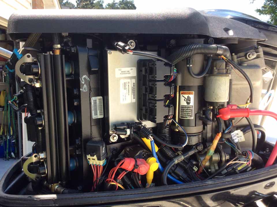

The Mercury 150 checked out but the compression check had a high reading cylinder. Boat ran fine and has ~160 hours on it. Original motor. WOT is 5500 rpms at 45 mph as specs say. Motor sounded a little off, hard to explain.
Reading all taken multiple times
1 - 104
2 - 108
3 - 108
4 - 130
5 - 106
6 - 105
Talked to folks and I expected all to be between 95-110.
Now I am new to Optimax motors and was wondering if any had any ideas on the high reading on cylinder 4. Verified all cylinders multiple times. Leaned to hate the plug placement :-)

Saw your post and pics on THT.I would not worry to much about slightly higher reading on one cylinder.It is almost always caused by build-up carbon on top of the piston. Ask seller if he only used Optimax oil specifically designed for them. Optimax hate to be babied and trolled below 1000 RPM for prolonged time - they need WOT and like to run hard at cruising RPM or higher . Also annual spark plugs replacement and minimum 89 octane is recommended. You mention something about motor was slightly off in your opinion. Optimax has very specific sound that no other outboard has. Theres a very noticeable ticking sound beside regular 2 stroke noise and its very recognizable at idle. Something like tic-tic-tic at higher rate. If thats what you hear its normal.
Every time I got a whaler with Optimax one of the first thing I did after purchase is take it for good long hard run staying close at maximum RPM as possible . It will burn out all the crap thats in the motor and make your OPtimax happy.
Had almost every Optimax from 75 to 225. Some had problems some not. I am very mechanicly inclined and was always able to fix them. There are 2 fuel pumps -low pressure and high pressure. They do go bad due to gunk in the gas and Ethanol. Disassembling the pump and cleaning it is not for faint of heart and is job for Certified Mercury shop.Use Mercury quick-kleen and startron fuel reatment religiously. Have good reputable water fuel water separator between fuel tank and the motor. And use boat as much as you can . Optimax is most happy when its often in the action.

Thanks for the reply. According to everything I have read one cylinder being 20% from the others is not normal. The other 5 cylinders are within 3% of each other. It is a puzzle in my mind. I have checked many compressions on 2 & 4 Stroke outboard motors. Have seen a couple which indicated problems on the outboard but usually one or two low readings. Never had I seen a single high cylinder.

I found out the I did the compression test wrong. Test should be done on warm motor with all 6 plugs out and throttle wide open. So I will redo test.
I purchased the boat and will pick it up tonight. The seller had a few other buyers lined up and I did not want to lose the chance to own the 2004 Nantucket 190. It was easily the cleanest I have seen in the 6 months I have been patiently searching for one and strangely the less expensive. Plans to update motor to Mercury 4-stroke in the next year or so. Research shows this Model Mercury Optimax in good running order can get $2K-$3K or more and even parts out around $1500 is not running.

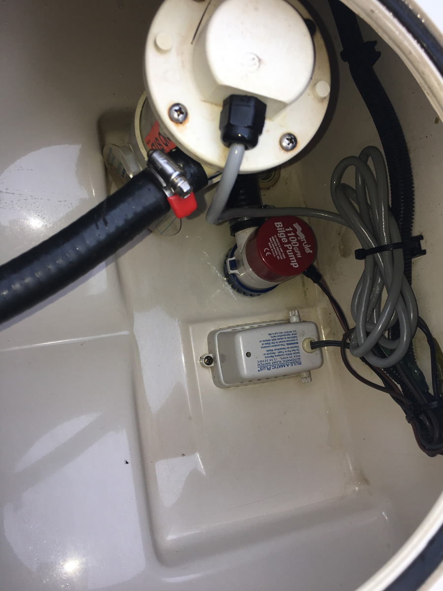

Well here is a lesson learned. The 190 Nantucket/Outrage has a bilge. I did not look in it before buying this boat. Hell I didn't really know it had one. I asked what the hatch between the leaning post and the motor well was for and the seller said to put the plug in & out. Ok I got lucky it was fairly nice. But thought I would document so no other members would make my mistake.
M

Wow invision you know you got a great boat if the bilge looks immaculate like that.
Happy Whalering.

Motor
Boat Photos

Bilge is cleaner than mine but geez all that going on under the cowling.

Not sure what you mean by what is going on under the cowling. Is something wrong in your mind with the OptiMax 150hp?
Boat Photos
Posts: 1801
Re: 2005 Nantucket: What about the deal?
Postby Jefecinco » Sat Aug 26, 2017 9:45 am
There is a lot of "stuff" or complicated looking parts/plumbing/machinery under the cowling. If you've never looked closely at a direct injected (DI) two stroke cycle outboard engine the appearance is surprising. Non DI two stroke engines look very simple by comparison. My previously owned Evinrude FICHT DI two stroke was less complicated because unlike the Mercury Optimax it did not include an air compressor. The Evinrude was also much less noisy.
You could say the FICHT was a first generation E-Tec as the design is very similar.

On that first pic of the motor -right there are 3 very important parts .White canister is water fuel separator. To the left and right are low and high pressure fuel pumps.You gonna have to make custom filter wrench to remove that water separator since no standard metal wrench will be able to reach back part of it. I made one from old seat belt and piece of 6 inch plastic with a vertical cutout that you slide that belt through and saw two sides so it looks like o ring. Seat belt is soft and flexible so you will be able to slide it behind the filter. Once in position start twisting plastic handle to make it tight enough to remove the filter .

Well I re-checked the compression the proper way and it was better.
1-124 2-126 3-127 4-127 5-126 6-125
Here is the motor in action on muffs.
Mercury 150hp Optimax
Going to put on our boat lift in a week or two. We will see how it does...

vze2gbs4 wrote:On that first pic of the motor -right there are 3 very important parts .White canister is water fuel separator. To the left and right are low and high pressure fuel pumps.You gonna have to make custom filter wrench to remove that water separator since no standard metal wrench will be able to reach back part of it. I made one from old seat belt and piece of 6 inch plastic with a vertical cutout that you slide that belt through and saw two sides so it looks like o ring. Seat belt is soft and flexible so you will be able to slide it behind the filter. Once in position start twisting plastic handle to make it tight enough to remove the filter .
I actually have a small canister band wrench that should work. I am delaying putting her in the water since the filter/water separator in out of stock and should be here late next week. I did change the gear lube and put new seals on the screws. The air filter is like brand new. This boat does not have a fuel filter in the bilge like some I have seen. Spark plug gap is at .40.
