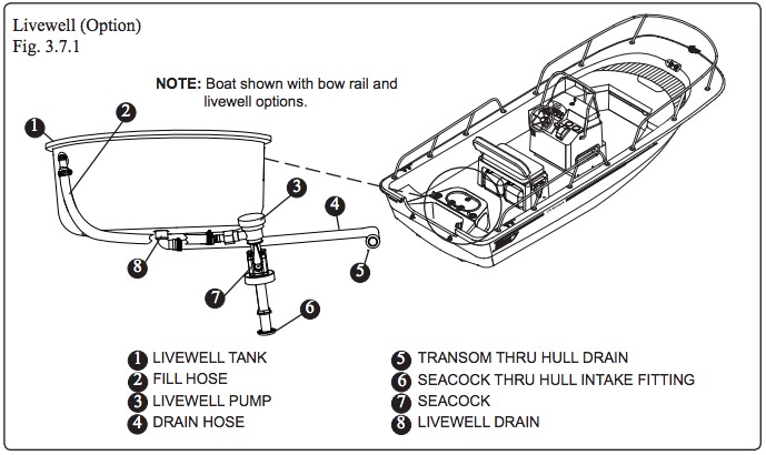

The owner's manual for the Boston Whaler 170 MONTAUK shows the arrangement of the LIVEWELL plumbing in a diagram titled Fig. 3.7.1.
The livewell option covers over the usual grate that provides access to the cockpit sump. It looks like there is an opening on the starboard side that would allow access inside the housing of the livewell, and that may be the route to accessing the sump area.
The livewell through-hull has a seacock. This would close the drain and eliminate the need to use any sort of external plug inserted into the drain outlet on the hull bottom. Since there is no need for an external plug for the livewell water inlet, it seems reasonable that none would be provided.
Assuming the drain for the cockpit sump is partially covered on the hull bottom, then no plug could be inserted into it, and the drain would be closed by inserting a plug into the drain on the inboard end. Not having a 170 MONTAUK with the livewell option on hand to check, I have to assume that Boston Whaler would have provided some means of access to this area to insert the drain plug, even though it appears that the livewell housing has obstructed access. Boston Whaler has been designing boats for about 60 years, so it would be quite unusual for them to create a situation in which an important through-hull opening could not be accessed.
