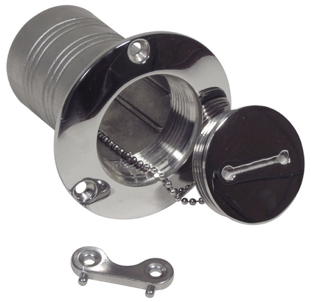

I just bought [a 2001 Boston Whaler 160 DAUNTLESS] boat; I am new to the Whaler family. The fuel tank cap has two holes and a rounded slot between them. Is there a special wrench required to open the cap?--glurtis

I have a 2003 160 Dauntless myself. The [fuel fill cap] is pretty much flush to the stern so it doesn't collect debris and can literally be stepped on if necessary. There is a simple key for these applications, it looks like this:

I suspect you probably have a fuel tank filler cap that resembles this one:
http://www.tanksinc.com/index.cfm/page/ptype=product/product_id=475/category_id=166/mode=prod/prd475.htm
I am certain that when the 2001 Boston Whaler boat was delivered, there was a wrench or key for that filler cap included. Check around the boat for one. Perhaps it is stored somewhere.

In a pinch a pair of needle nose pliers will open that type of fuel fill cap. A nose in each hole and turn the handles.

The back of a closed blade on my 3 1/2" Spyderco folding knife fits the slot in this fuel cap perfectly.
2003 160 Dauntless purchased used in 2008. No fuel key in otherwise complete documentation from seller. I've see the appropriate key on rings at various fuel docks, so that part must be available somewhere.

The technical term for it is a DECK PLATE FILL KEY.
Perko makes a plastic version: https://www.fisheriessupply.com/perko-deck-plate-key-1247dp0blk
