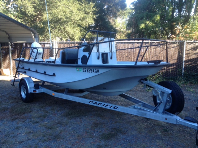

This is a 1986 [DIVEMASTER] 17. I'm new to Whalers but had admired them since I was a kid. I bought this one last year, at which point it needed a lot of work. The E-TEC 90 was in good shape, but all the wiring, electronics, Evinrude wiring harness needed to be replaced. I refinished all the stainless, rebuilt the console, and had new steering, new throttle controls, and all new fuel plumbing installed. The project was a lot of fun, and the boat has performed extremely well since I finished it. Mostly I use it for diving in the Monterey, California area. The photo is from Lake Tahoe, which is another great place for boating.
The [DIVEMASTER] is great for diving. The railings and grab handles are from Boston Whaler; the ladder was added by me. The console is forward, leaving a larger area aft for preparing gear. The only downside I've noticed is the extra weight of the hull and railings, which reduces the amount of other gear that can be carried. Diving gear is so heavy that this can be a concern. But so far I am very pleased with how it all worked out.

Wow nice looking [DIVEMASTER 17]. First one like that I've ever seen. The 17 hull is already great. I've had several regular 17-foot [Boston Whaler boats] and enjoyed them very much. I have the 18 Guardian pictured in the "Show Us Your Whaler] thread and fully appreciate your 17. admirable boat, you did nice restoration work on her. What kind of speed do you get out of her? Thanx, Mav in South Carolina

Actually " gchilcott " that is a 17 Divemaster and not a Guardian. The Divemaster is a much rarer boat.

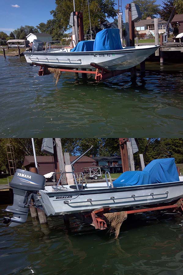

Here is another 17 Divemaster that has lived on a lift down from our family friends house on the Detroit River / Grosse Isle.

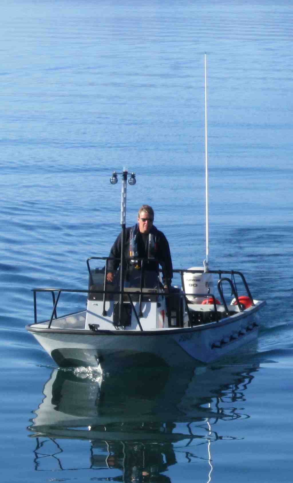

I have to ask: what is on the tall mast just forward of the center console?

jimh wrote:I have to ask: what is on the tall mast just forward of the center console?
I think the mast is part of the "dive" package that also included the aft railings and forward console (see Jeff's comments about this).
The mast has a white nav light on top, and two flood lights facing forward (Hella LED deck lights). I have it set up to also use the white nav light individually as an anchor light. Ordinarily an anchor light wouldn't be important for a small open boat, but the extra height is useful for seeing the boat more easily at the end of a night dive. When in the water looking from about water level it doesn't take much chop to reduce your field of view substantially.
I do not know if the flood lights were installed originally, but they were there when I got the boat so I just refurbished them with the rest of the electrical. I also use the mast to fly an alpha or dive flag from the mast when diving, especially when the boat is at anchor with nobody on board. The cylindrical device on the top front of the mast is a radar reflector.
The design of the mast and bracket is ingenious. The lower end of the mast is cut at an angle, which sits in a complementary seat in the bracket. That maintains the direction of the mast with no fasteners or pins. I have the wiring set up with waterproof plugs, so the mast can be lifted out and stowed in the cockpit during towing or when parking with low overhead clearance. Stowing only takes a few seconds, so dealing with the mast adds almost nothing to boat prep prior to launching.
Re: DIVEMASTER 17
Thanks for the explanation of all the gear contained on the mast and its ingenious mounting method.
I also noted the radio antenna on the stern railing. It seems like it is longer than the usual 8-feet of most antennas. If you ever need to replace it and you want to continue using a fiberglass-encased antenna, perhaps get one with a black finish to match the rest of the black gear.

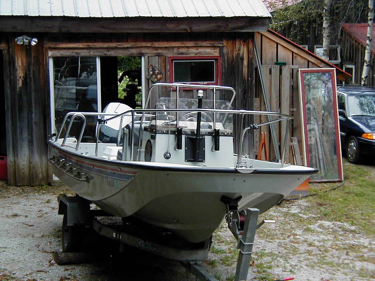

I have the same rig. It is a 1987, haze grey, red dot hull that the original documentation describes as a Guardian-17 with no reference to the Divemaster name. Chuck Bennett made no mention of Divemaster when he responded to my email seeking information on the hull. I was under the impression that a Divemaster had a cutout in the hull for boarding, even in the 17' version. I'm certainly not claiming that to be a fact, just something I thought I read.
Mine is set up for fishing, trolling specifically. The extra space is great. The tank racks make a great platform for mounting downriggers etc. The mast bracket on the console made it easy to modify a planner board mast to slide right in.
