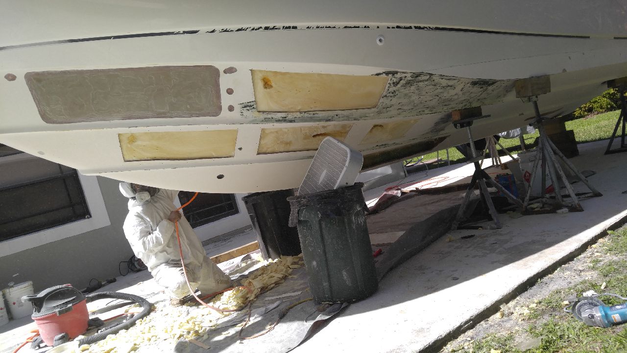

Hi Joe . Did your boat have a name[?] I purchase a similar boat some years back. We ended up fixing it from the bottom by creating a stringer system.

Yes that was [the same boat]. I still have your hats. Great boat after we repaired [the hull]. The boat is now in Martinique, France. I have pictures of the repairs. We perfected what I consider a Boston Whaler glitch in 1999. I have another Boston Whaler boat from the same year: it has the same hull problem.
