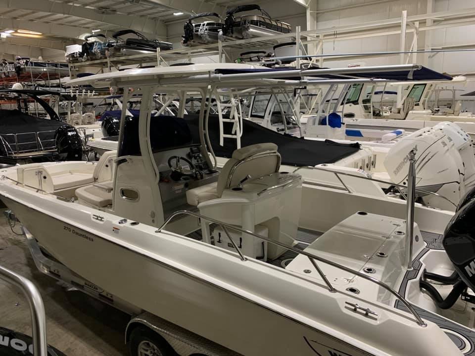

Quick update, last week I took delivery of my new 270 Dauntless. I found a leftover 2018 model that was rigged with twin 225 Verados, swim patio, windlass and bow and aft Sureshades that I wasn't crazy about but my wife loves them. I will be shopping around for a trolling motor, looking at the MotorGuide Xi5, the Minn Kota Riptide Ulterra and the Rhodan HD GPS Anchor+, all in 36v.

That's a beautiful Dauntless. I didn't know they were available with a "diving door". Is that what is meant by "swim patio"? That will be a very useful feature when landing a large fish.
Re: 270 Dauntless: Trolling Motor; Single v. Twin Engines; More
Nice boat—actually extremely nice boat.
After you get through the VERADO engine break-in period, I bet it will be fun to hit 55-MPH.
Also, to learn if one engine can get the boat on plane and get above 20-MPH will be interesting to know.

Jefecinco wrote:That's a beautiful Dauntless. I didn't know they were available with a "diving door". Is that what is meant by "swim patio"? That will be a very useful feature when landing a large fish.
Its not really a door per se, its more like a platform that opens down and lays just above the waterline, it comes with a ladder that you attach which makes boarding very easy. The first time my wife saw it she fell in love with it and from then on every boat we looked at, and we looked at a lot of them, fell short because they didn't have this platform. In fact, the 270 Dauntless had 2 features that no other boat in its class had, one being this platform and the other the forward seating area including a huge storage compartment in front of the console that forms a double lounge seat with arm rests.
