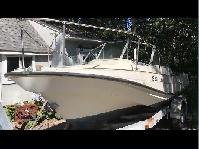

"Hi dear - look what followed me home"
1975 Revenge 21 - my winter project.
Dave
My 1975 Revenge 21
Re: My 1975 Revenge 21
Nice boat Dave, lucky that it followed you home and liked the Admiral.

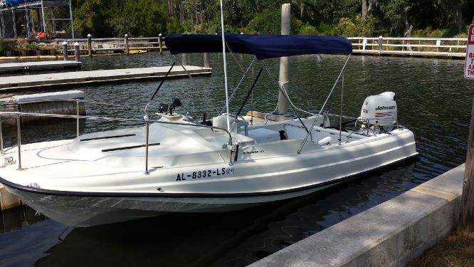

Ten years ago with a 1978 Revenge banana hull the same happened to me.
Looked like your boat.
I stripped off everything, including bottom paint.
Now looks like this.
Decided to leave windshield off, put leaning post by helm, and use ice chests and folding deck chairs to have optimum deck space that is reconfigurable.
Put on a 140 Johnzuki short shaft—perfect engine for this boat.
If now I would probably choose an E-TEC G2.

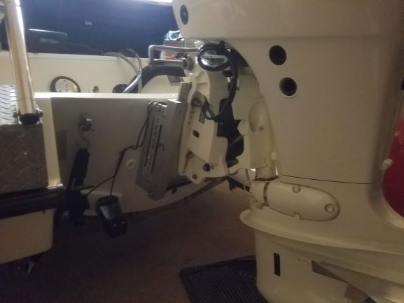

I can’t believe the transom is notched for a 15-inch-shaft outboard. That cannot be a stock transom.

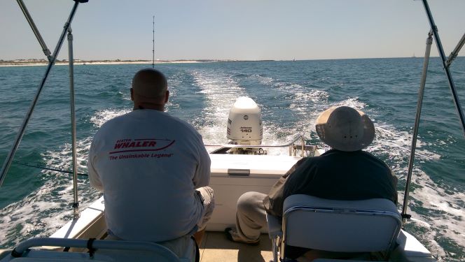

As usual Jim is correct. The motor is NOT a short shaft. There are SHORT, LONG, X-Long, and XX-Long shafts. When I bought it, there was a row of them and it had the shortest shaft of them all. The sales-guy said it was a short shaft and he couldn't sell it because all the boats around Ft. Pierce being sold were deep Vs and they needed the longer shafts... meaning X-Long or XX-Longs...
The transom on the Revenge 21 is 24" and I have my Johnzuki on a jack-plate too. So my motor is actually a LONG shaft, but compared to the others it sure looked short. (Also fishing buddy is wearing one of our old Continuous Wave Whaler shirts) need to make another run of them?

My inference from your comments: your 1975 REVENGE 21 has the stock transom, and uses an engine with a 20-inch shaft.
With the mounting you show with the added jack plate, you should have plenty of range of adjustment in the engine mounting height.
