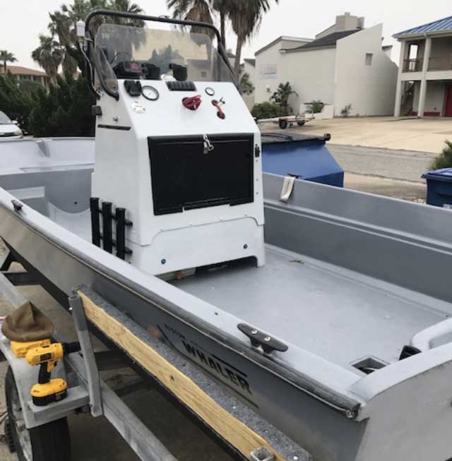

I plan to re-power a 1963 16-foot highly customized Boston Whaler hull with an E-TEC 90 H.O. or a Suzuki 90.
If I install either engine myself, with the factory warranty be honored?
I’ve sent questions to two dealers via e-mail and got no response.
The boat is almost ready for a new engine.
--Mav

P.S. No de-rigging needed. Dealer would have to saw the binnacle shifter hole, and hole a saw for tachometer. This hull was very dry and light, but well used as a beat up work boat when I purchased it cheap. I took some latitude in the mostly non-OEM refit. I used a console I already had.
Fig. 1. Highly customized 1963 16-foot hull.
