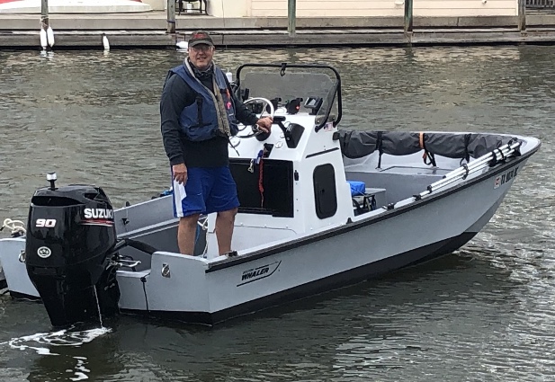

On May 8, 2020 I took delivery of my just-repowered custom c.1963 16-footer with its new SUZUKI 90-HP engine. Huff Marine of Corpus Christi, Texas, installed the engine and new hydraulic steering; they did a phenomenal job. I was considering doing the installation myself or paying $1,500 in labor and miscellaneous controls and having the dealer do it. I chose the dealer. The installation worked out great. Sometimes paying the man is worth the peace of mind.
Fig. 1. The custom 16-footer with its new SUZUKI engine at the dock.
I only have three hours run time on the SUZUKI 90-HP--breaking it in. The engine runs quietly and looks great. I appreciate all the great advice received on this forum. Thanks--MAV

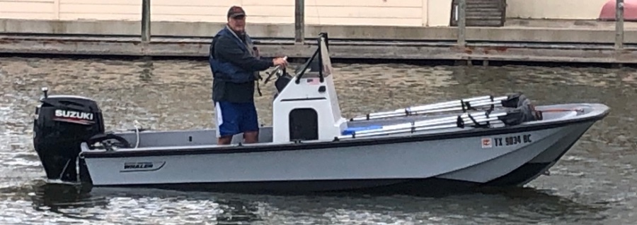

Fig. 2. The 1963 customized 16-footer at Padre Island, Texas.

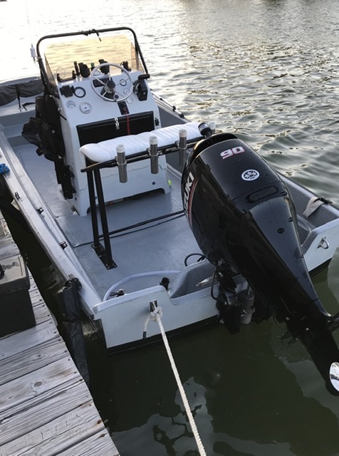

Fig. 3. The hull was redone with gray gel coat.

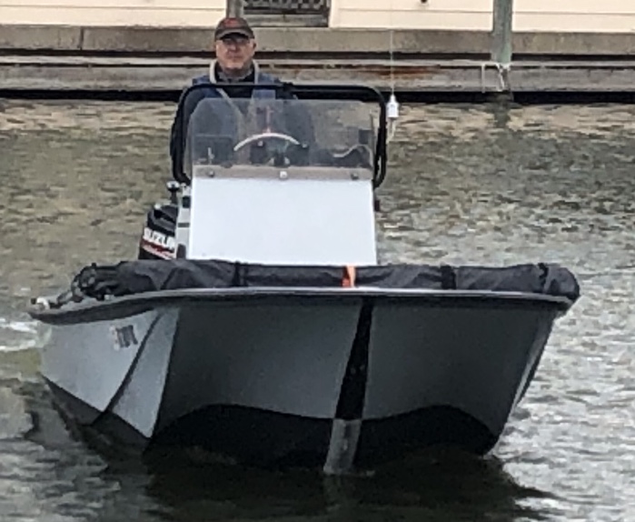

The boat looks like it belongs to a government agency. You need to be in a military uniform to be at the helm--maybe Coast Guard blues.
An orange slash on the forward quarter of the hull sides would be a nice touch, too. Other boats will get out of your way.
I salute you for this restoration.
The proportions of the SUZUKI 90-HP are a good match for that hull. It looks very good back there.

The boat was flipped upside down and bottom and entire exterior sanded down to original gel coat and some minor repairs from previous owners. Looked good. Very light as my son and I rolled it. The hull was re-gel-coated in gray. Added a stick-on keel guard by Megaware--a great and tight fit. The hull bottom has anti-fouling paint; here sea growth is aggressive.

Fig. 4. Coming at you.

Good job! I guess we can now officially say the 90hp Suzuki 4 stroke is NOT too heavy for a classic 16/17 hull. Static trim looks great.

Thanks Biggie. Yes rides really high - hull is light and dry. Anxious to see hole shot and top end, my first 4-stroke. Propped with 19” SS Powertech. Slowest at idle is 2.1 mph. Just barely increasing idle is 6 mph. Have two more hours break in then can open it up. I’m thinking it’s going to roll pretty good given the weight. Thanks Mav

What exactly is going on with the navigation light on the engine? That does not look legal or very useful.

As far as I know [the lamp on this boat] is legal as long as the height is in line with state/federal requirements. Pretty popular down here for some reason. I think it keeps it out of the way when fishing or throwing a net. Personally I think they just ruined a $500 engine cowling and every time you remove the cowling you need to disconnect the wiring.

The white all-round lamp mounted on the engine is clearly not legal under federal navigation rules. The white all-round light must be shown at least 1-meter higher than the sidelights, and it has to be visible in a 360-degree arc of the horizon. The sidelight lamps on this boat are at the console. The white all-round lamp is just about at the same height as the sidelight lamps. The white all-round light on this boat is blocked by the center console from being seen from ahead from a significant portion of the required 360-degree of the horizon. So it fails on two important parameters: arc of visibility and vertical height separation from the sidelights.
The boat is used in Texas, and perhaps Texas has different regulations about navigation lighting.
A better solution would be to mount the white all-round lamp on a pole from the middle of the center console, and provide a shade to keep the light off the helmsman.
I agree with NICK about the modification to the cowling. Also, keeping the lamp wiring out of the engine flywheel will be a concern.

While it may be "functional" to the operator, an all-round light installed on an outboard engine cover does not help fellow boaters transiting nearby at night.
I highly recommend Mav remove the light, use grommet covers to seal the cover holes and install an appropriately tall stern mounted all-round navigation light.
