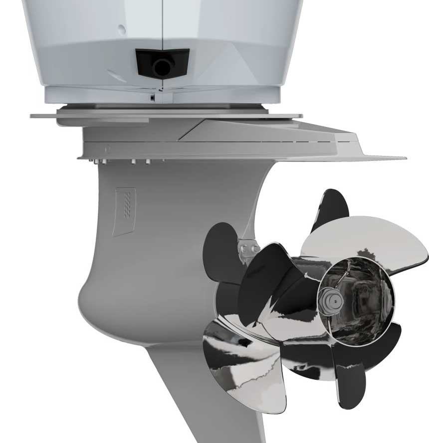

The completely new steering arrangement for the new Mercury VERADO 600-HP V12 engine is perhaps the most novel element. The power head does not rotate on the transom; only the gear case rotates. The rotating joint has to be under tremendous stress with 600-HP passing through it. It is not clear if the joint also has to be water tight. I would assume that to rotate, the drive shaft, exhaust ports, the water inlet path, and any gear case linkage must be on centerline or in some very crafty arrangement to create a rotating joint.
FIg. 1. The rotating gear case on the Mercury VERADO 600-HP V12 engine
Also unusual is the combination of three-blade and four-blade propellers. Based on the blade orientation seen above, the two propellers are in opposing rotation.
Another thought: if the engine drive shaft is input to a transmission, then perhaps the forward-neutral-reverse gear shift occurs in the transmission, and the gear case is just a 90-degree geared connection of the drive shaft to the propeller shaft with no clutch or gear shift.
