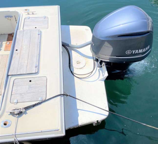

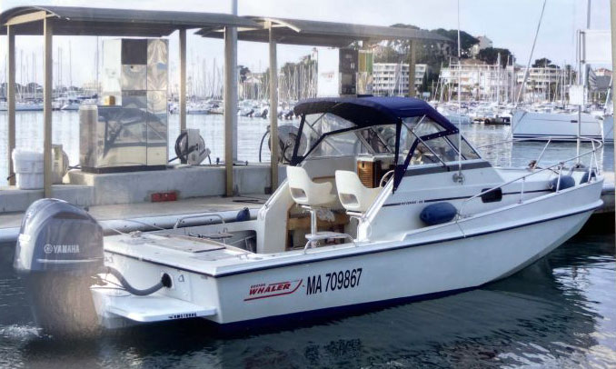

I am considering buying a Boston Whaler boat in France. I understand that it is a 1986 25 REVENGE Walkaround Whaler Drive.
Fig. 1. 1986 25 REVENGE for sale in France.
[Based on Figure 1] is the engine bracket an OEM Whaler Drive?
What will be the performance of the boat with the Yamaha 300-HP V6 engine?
Does this boat need flaps [trim tabs]?
Is an auxiliary engine needed?

In the 1986 Boston Whaler catalogue the boat is called a REVENGE 25 FULL CABIN. It is also called a REVENGE 25 Walkaround in some other literature. The boat was available with three power options: outboard engines with a notched transom; Sea Drive engines with a full transom, or; sterndrive engine with a full transom. There was no option listed for a Whaler Drive.
The engine bracket shown in Figure 1 does not look like an OEM Whaler Drive engine bracket. Typically a Whaler Drive will have a much larger buoyancy box that extends the full width of the bracket. The bracket in Figure 1 only has a buoyancy box in the center portion of the engine bracket. The bracket may be aluminum. A Whaler Drive would be of molded fiberglass construction.
The boat may have been originally built for Sea Drive engines, which could have been replaced with a non-OEM engine bracket and an outboard engine, as shown. This history for the boat is the most likely.
If the boat were originally built for outboard engines it would have had a notched transom. If that were the case, then the full transom conversion was done after the boat left the factory.
The boat was rated for maximum horsepower of 300-HP.
The top speed of the boat will have to be estimated based on total weight, power, and hull type.

While the boat shown is not technically a "whaler drive" (WD) model, it could have been when originally manufactured. At some point an owner replaced the WD with an Armstrong brand bracket. Armstrong is an American company specializing in brackets and is well respected then and now.
It appears the installation of the Armstrong bracket is well done so it should not be seen as a negative when assessing the boat.

Phil T wrote:...the boat... could have been [a Whaler Drive model] when originally manufactured. At some point an owner replaced the WD with an Armstrong brand bracket.
I don't see a basis to infer that the boat originally had a Whaler Drive, as that option is not listed in the 1986 Boston Whaler Catalogue. In the catalogue there are three outline drawings of the boat as seen from above: Outboard, Sea Drive, Stern Drive.
In the more detailed 1986 Options and Price list, on page 43 for the 25 REVENGE WALK-AROUND CABIN, the Engine Option list notes:
Beyond the standard outboard model, this boat is also available in Stern Drive or Sea Drive power. Stern drive models use MERCRUISER 260...Sea Drive models include OMC SEA DRIVE twin 1.6 litre or single OMC SEA DRIVE 2.6 litre with VRO. Sea Drive models also add a 43-gallon removable fish well and hydraulic steering.
Other options listed are for "I/O" blank (for customer or dealer installation of a sterndrive engine) or SEA DRIVE blank (with a full transom and no further bracket of any kind), or a GIL BRACKET "for Sea Drive Blank only (Dual installation).
The base price for the REVENGE 25 WALK-AROUND CABIN or 25 REVENGE FULL CABIN in 1986 was $28,790. The SEA DRIVE blank price was $29,750--an additional $960 to fabricate the hull with a full transom.
The only other option for a full transom boat was the Stern Drive, but a Stern Drive boat would have a modification for mounting the inboard engine and an engine box in the cockpit.
I do not believe there are any remaining OMC SEA DRIVE engines actually attached to the transom of a Boston Whaler boat. On that basis I think the most reasonable inference about the history of this boat is that it came as a SEA DRIVE boat.
If the Boston Whaler hull stencil number or the federal Hull Identification Number can be located, the by contacting Boston Whaler customer service the actual configuration of the original boat may be possible to confirm.
Also, I am not aware of any actual Boston Whaler boat that was manufactured with a Whaler Drive having had the Whaler Drive removed and replaced with some other after-market bracket. I can't recall anyone even mentioning that as a possibility. People who own boats with the Whaler Drive option tend to be quite fond of the Whaler Drive. The only person I know that tends to disparage the Whaler Drive has never owned a Whaler Drive boat and thus has never removed a Whaler Drive, even though he seems very confident that a Whaler Drive was a speed reducing device and eschewed their use.

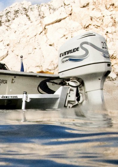

I have found some explanations and pictures about replacing a [OMC Sea Drive] by a Armstrong bracket on a 27FC [on some other website.] and that boat seems to be the same technical case as this boat.

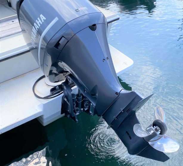

Some pictures of the Yamaha F300 and the cockpit
Fig. 2. The Yamaha F300 engine
Fig. 3. The Yamaha F300 engine

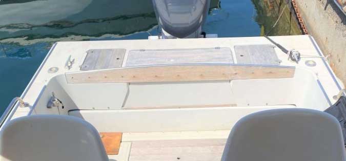

Fig. 4. The aft cockpit

The aft cockpit bulkhead as shown in Figure 4 looks a bit unusual to me. Compare how that bulkhead appears with the bulkhead on an OUTRAGE 25 that was ordered as a Stern Drive Blank which appears below as Figure 5.
Fig. 5. The cockpit aft bulkhead on a 25-foot OUTRAGE that was ordered as a Sea Drive Blank. Note how the cockpit aft bulkhead differs significantly from the one seen above in Figure 4.
Fig. 6. Another view of the aft cockpit bulkhead on a 25-foot OUTRAGE that was ordered as a Sea Drive Blank. Note how the cockpit aft bulkhead differs significantly from the one seen above in Figure 4. There is no missing center section as seen in FIgure 4.
I am now wondering if the boat under discussion might have originally been made as a stern drive model because of the cut out in the aft cockpit bulkhead that seems to correspond to where the cockpit engine box would have been on a stern drive model.

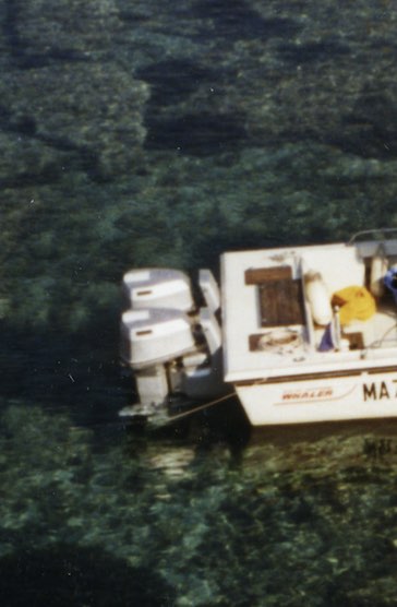

The owner kindly gave me a few days ago the answer about which model it was, before the Armstrong Bracket.
Look at the pictures, it seems two SEA DRIVE engines were on the boat before this new bracket. And the winner is SEA DRIVE mounts.
sea drive.jpg (41.66 KiB) Viewed 6312 times
evinrude armstrong.jpg (51.81 KiB) Viewed 6312 times
