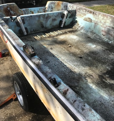

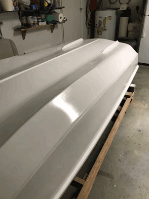

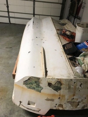

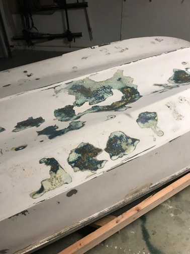

I'm finishing up restoring and modifying a c.1970 13-footer. This boat was purchased by my Father in 2000. He said that at that time it "looked good" with no significant [damage]. It had been restored by the seller who had owned it since c.1997. My father also received a title to the boat that listed it as a 1980 and had a hull identification number for a 1980 vessel. After using the boat for about eight years in a lake--sometimes left in the lake and sometimes pulled up on shore-- he gave the 13-footer to my brother who stored it on a trailer in his backyard until I rescued it in December 2019. You can see from the pictures below that the c.1970 13-footer had not weathered well.
Fig. 2. Bottom as Started
Bottom as started.jpg (69.02 KiB) Viewed 4039 times

FIgure 2 and Figure 3 show areas of missing gel coat on the hull bottom and transom. Those areas with no gel coat could have had water ingress and then broke off in winter with the freezing temperatures. You cannot keep a Boston Whaler hull in the water all the time without any epoxy sealing paint on the bottom to keep water out of the laminate.

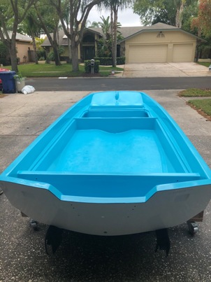

To refinish the hull [of the c.1970 13-foot hull described earlier] we used West System Epoxy, silica, Microballons, fiberglass (in various thicknesses), wooden dowels, foam board, Epifanes two-part primer, and two-part yacht coating in Boston Whaler blue.

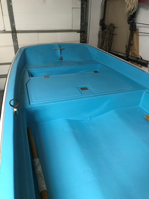

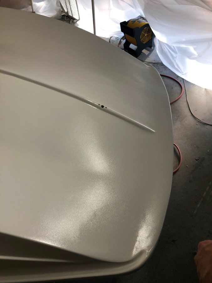

I wanted more storage and a casting or standing platform. We added a compartment just aft of the original compartment. My Dad had a hatch cover from a 1981 OUTRAGE he once owned, and we built the new compartment around the dimensions of that cover.

That boat has made quite a comeback. Your work is very nice and may inspire others with old hulls in similarly less-than-new condition.
That you have pictures from before and from after the work enables us to see what was accomplished.
