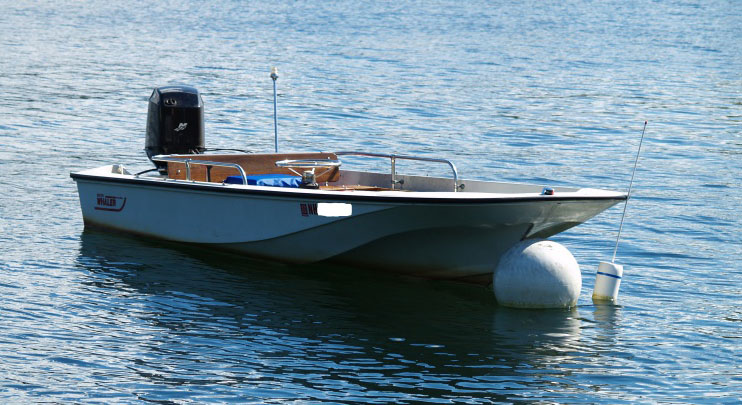

Now I will share some details about my c.1985 SPORT 15, a family island shuttle. Our family has owned the boat from c. 1999. I describe the boat as a c.1985 because the stencl number is 5A46nn--that sounds to me like later production run.
In 2007 the c.1985 SPORT 15 was re-powered with a Mercury 50-HP two-stroke-power-cycle outboard. The boat is used only in fresh water on a lake New Hampshire lake to get us from shore to our island property. It's the shuttle boat, carrying propane tanks, groceries, dogs, kids, etc.

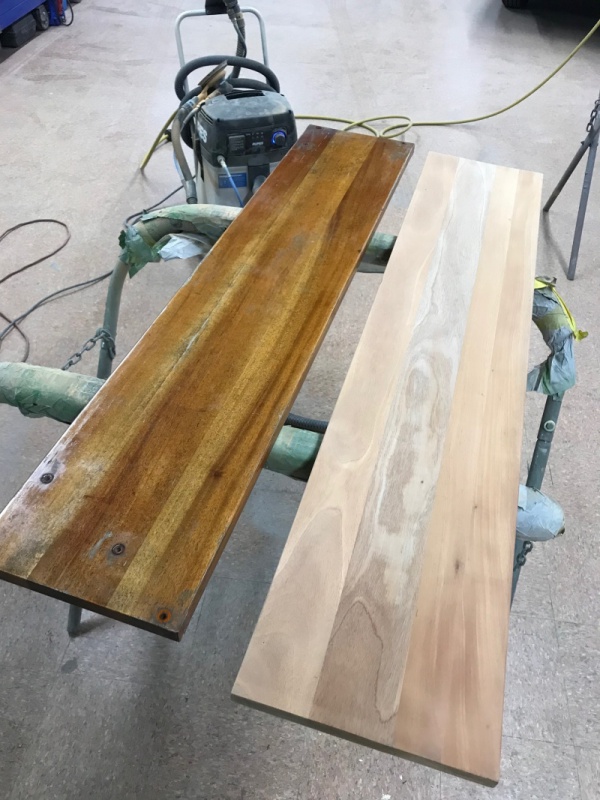

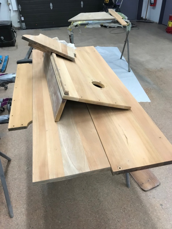

In Fall 2020 all the wood was pulled out of the boat prior to lay-up for winter. On April 10, 2021 I had some time to sand down and strip off the old varnish off. I've seen a lot of questions about Specialty Marine's wood kits as on he forum. I can assure anyone who is curious, it's solid wood. No laminate or plywood. I wanted to ensure I got more than six more summers before the wood needed stripping and sander. To that end, I fully sanded off all the finish and got down to bare wood, instead of just scuffing up the varnish and recoating it.
While sanding down the varnish, I thought I was stripping off both layers of clear varnish and stain from the wood.
After sanding to bare wood, I created a test spot of Interlux Perfection plus. I found the wood had a more yellower color than before sanding. Based on this, I suspect there was a layer of stain on the original wood before varnishing to help it achieve that mahogany color so well known in Boston Whaler boats.
Based on this test, I wasn't happy with the outcome. I'm exploring other options.

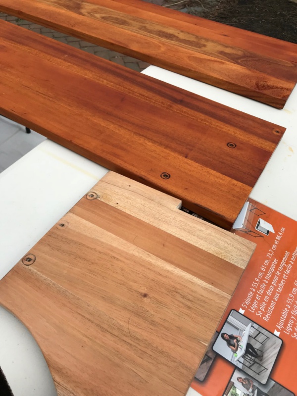

My paint booth at my shop has been busy, so I on April 10, 2021 I starting the process outside. I will apply final coats in the booth via HVLP. The goat end was build base coat layers.
The first step was to apply the AwlGrip Red Primer. I let the primer cure for six hours based on ambient air temp, and I just applied the first brushed coat of AwlGrip clear. I hope to have the second coat applied later this evening, with another two or three coats tomorrow.
In my reading, I've seen some people mention building their base coating with the AwlGrip clear, and then doing a topcoat of AwlGrip 2000. I'm undecided if this is the path I'll take.

Re the wood in Fig. 3.: the sanded board does not look like mahogany wood.
Re the color of the wood in Figure 4: I like the look of the red primer.

After looking at the photographs I can see the wood featured is not plywood but it does not look solid. Rather it seems to have been made up from thinner planks side glued together side to side and it does not look like the same type of mahogany used on our 1981 Sport 13. Perhaps that's a characteristic of mahogany. It looks good and obviously holds up well.
