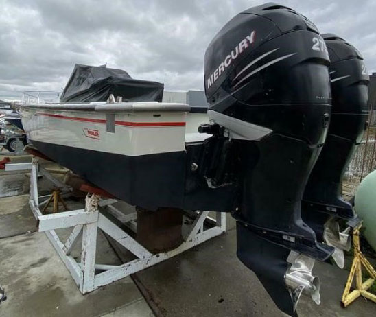

I have seen photo's of the boat and it is definitely an Outrage 25 without the WhalerDrive, the two Verado's are on the transom of the boat.
She is sold through a broker (but not a very reputable one) and there is something off when you look at the pictures, it just doesn't look right. Also the waterline shows serious signs of leaning back in the water. Not enough buoyancy to support the two beasts. Will technically challenge myself and see if i can put the pictures up in my next post.

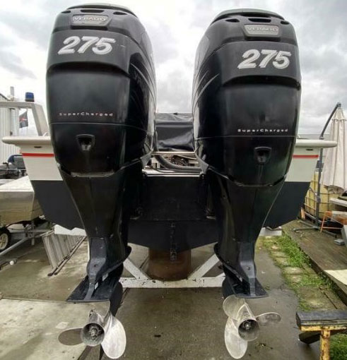

Below are photos of the boat. It is definitely an Outrage 25 without the Whaler Drive. The two Verado engines are on the transom of the boat.
The boat is sold through a broker--but not a very reputable one--and there is something off when you look at the pictures. It just doesn't look right. Also the waterline shows serious signs of leaning back in the water. Not enough buoyancy to support the two beasts.

Fig. 1. Afloat
Fig. 2. Stern view
Fig. 3. Stern quarter view
Fig. 4. Bottom paint

There is some irony in this discussion. There have been very few classic-era OUTRAGE hulls re-powered with a six-cylinder VERADO engine, but the one I recall seeing was on an OUTRAGE 25 hull. To see an OUTRAGE 25 with notched transom with two VERADO six-cylinder engines is really quite astonishing. I am surprised the hull could handle all that weight. And I don't think it really does handle it.
Based on Figure 2 and where the bottom paint is applied, the boat's static water line at the transom had about ZERO freeboard.
The general rule for assessing weight on the transom is the location of the engine splash well drains relative to the water line. On the boat seen here, it appears the engine splash well must have ALWAYS been full of water at rest. Perhaps underway the boat gained some freeboard at the transom from the hull lift and propeller lift.
In Figure 4 the aspect ratio of the image looks like it was stretched horizontally. This may be from use of a lens with an extremely short focal length.
