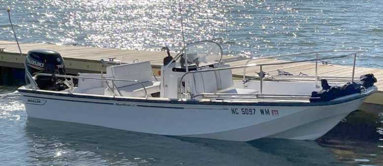

I have 24 hours to accept or reject the purchase of a 2000 Montauk 17 with a Suzuki DF70 shown below.
Q1: Does this boat seem to be floating on its lines?
Fig. 1. Waterline at static trim.

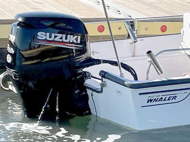

Fig. 2. Close-up of engine and transom.

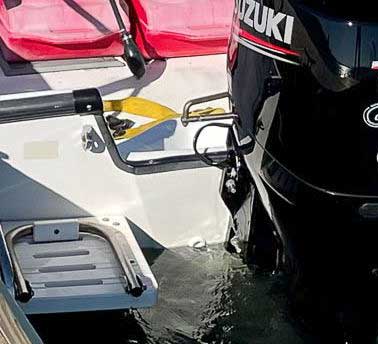

Fig. 3. Close-up of hull drain relative to waterline

I recently purchased a 1985 Montauk 17 and re-powered with a Suzuki DF 90, same weight as a DF70. I bought it with a Yamaha 115 4-stroke on it, and the battery located in the stern, and the splash well drain plugs were well under water. After re-powering and moving the battery under the console, the transom splash well drain holes are both still under water--but just barely.
I have gathered from this forum that old Boston Whaler boats [at their static trim] are just that way [i.e, their transom splashwell drains are underwater].
I have read not to drill holes, as very minimal water will come out that way. I have also read to drill weep holes, and they do help.

The hull is sitting just fine.
Moisture meters are not accurate on Boston Whalers. There are other techniques used to determine water ingress.
The water line below the drains is indicative of a pretty dry aft hull.
