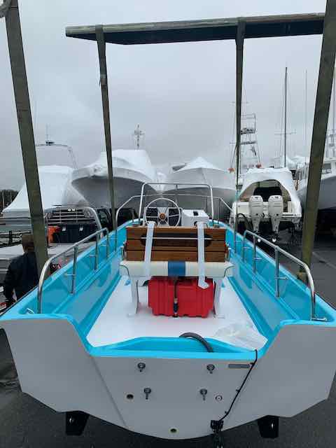

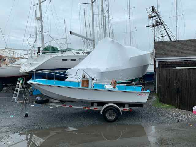

I was lucky enough to find pretty much exactly what I was looking for: a restored 1985 Montauk 17 without an engine.
Fig. 1.
Fig. 2.
Fig. 3.
Fig. 4.
Fig. 5.
Fig. 6.
Fig. 7.
Fig. 8.
We have owned an 1987 Outrage 22 since new, and I am familiar with Boston Whaler boats.
I questions on Bimini choices and what propeller to sue for this Montauk.
The boat likely won’t be loved by the purists, but I truly like the look. The boat has grown on me, and the boat really looks clean in person. The hull was redone with Awlcraft [from AWLGRIP], and the color scheme is basically a blend of the classic blue and white. The restoration has honestly all been redone, from drain tubes to teak, the boat was fully restored but never re-powered.
The engine will be a Honda BF90 that has been ordered and arrives “soon”. The new power had to be a Honda so I got a 90-HP as the 75, 90, 100-HP engines all weigh the same, but the 100-HP engine needs premium fuel. The BF90 weighs about 359-lbs--so it's not light--but I hope that the battery installed in the console (rigged that way when I bought it) will offset the engine weight.
Q1: What propeller should be used for this MONTAUK 17 with Honda 90-HP engine.
A knowledgeable guy said get a SOLAS 17 stainless steel propeller. I could only find aluminum SOLAR 17 propellers.
I assume the Honda engine should be mounted as many as high possible. I do know know the number of mounting holes on a HONDA engine mounting bracket.
Additionally, I really think it will need a Bimini. I don’t love the ones that lie flat in the bow.
Q2: what Bimini tops can be stowed in the op position and look more like arches?
Prop Rec's
Postby Phil T » Tue Mar 29, 2022 5:21 pm
Owners of the Montauk 17 with the HONDA BF 90 engine have tested propellers. The recommendations for this hull and engine include:
13.25 x 15 Solas Stainless Steel
13 x 17 Honda Stainless (Honda Turbo prt # 08M60-ZW7-A10)
Size listed is for the specific Make/Model and are not transferable.
The engine needs to be mounted two-holes-up with the top bolt in the third hole down from the top. Do not accept any malarky from the dealer saying that is too high.

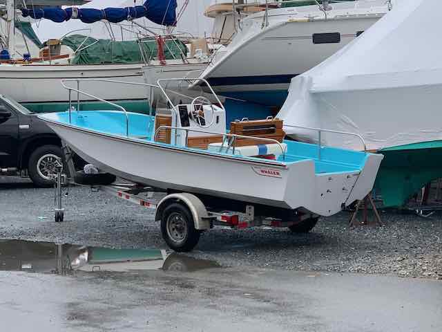

The boat looks great, and--while a departure from original--I can appreciate your changes.
While the rub rail and color are different, I would have positioned the Whaler logo in the position is came from Whaler; that is probably the biggest eye-catching detail that says the boat isn't original.
I did a restoration on my 1986 Boston Whaler and changed many things, but made sure to apply the decal in the original position.

Good eyes. The logo seems to be both too small and too far back.
Full disclosure: I had nothing to do with any of the modifications, colors, or rub rail choices. I just luckily stumbled upon the boat for sale the way it is.
The boat just got up to Massachusetts last Friday, and before that I had only seen it in pictures and for about 20 minutes when I bought it.
I am trying to figure out changing the logo and how much effort that entails.

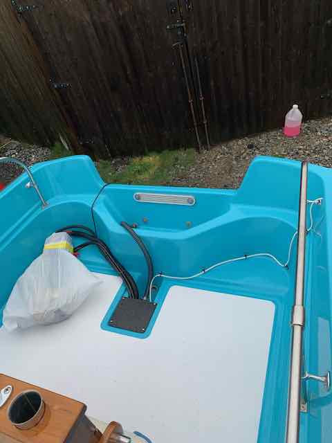

Also the hull needs rear towing eyes and a white all-round lamp. There is plenty to think about before it goes in the water.

The two-tone blue-white color scheme reminds me of a c.1955 Chevrolet car. They offered several two-tone paint schemes back then.

[The two-tone blue-white color scheme is] certainly not a look I had ever seen before on a Whaler. The scheme has really grown on me, especially in person. When it got up to Massachusetts, the guys at the boat lift and marina where there are a lot of old Montauks, didn’t really mention the colors; they only said that it looked like it just came from the Rockland factory up the road.
MORE BACKSTORY: I had been trying to find a restored ribside, but my kids and wife all hated the look of those boats, saying a ribside looked like “something that was used at D-day”. Then when I stumbled on this boat I first saw pics and was like “ehhh I don’t know”, but my kids and wife really liked it as I guess they are not Boston Whaler purists.

The reversible pilot seat seen above in Figure 8 looks great. The seat cushions with the blue piping and the blue center section continue the blue-white theme of the deck and interior color scheme.
The overall condition of the boat looks excellent--a ten. Now your task will be maintaining it at that very high level of appearance.

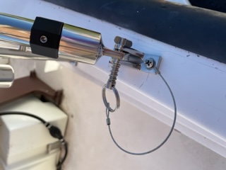

Below are photos from the installation done today. I installed the top with the stainless steers rear supports and affixed quick release pins to them so that I can lower the frame for winter storage under full boat cover.
Fig. 10. Quick Release Pin on Rear Support
Quick Release Pin.jpg (30.53 KiB) Viewed 13172 times

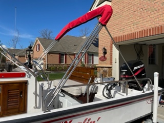

Fig. 11. Bimini Deployed
Whaler Full Bimini.jpg (41.75 KiB) Viewed 13172 times
Fig. 12. Bimini Folded and with Boot
Whaler Bimini Folded.jpg (49.98 KiB) Viewed 13172 times
Fig. 13
Whaler Bimini Mounting Position Primary.jpg (42.69 KiB) Viewed 13171 times
