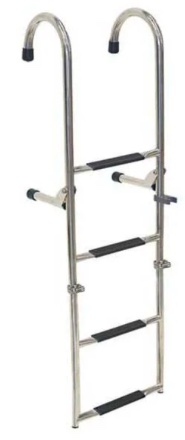

I use a boarding ladder that fits on the gunwales. The ladder is awkward to stow when not in use, but the ladder is very useful for climbing aboard the boat from the water. The ladder I use is an off-the-shelf ladder. The particular ladder I bought was sold by WEST Marine. The vertical tubes of the ladder have a U-bent at the top. The ends of the vertical tubes of the ladder have a small device that fits into receptacles bolted to the gunwale. This fixes the ladder in place, which gives the ladder more stability.
Fig. 1. A boarding ladder that attaches to the hull at the top of the gunwales.
See
More information at: https://www.westmarine.com/buy/west-mar ... cordNum=11
A key consideration in a boarding ladder is how deeply the bottom step of the ladder will be immersed in the water. For swimmers with less agility, having a deep lowest step on the ladder will be a great advantage in boarding the boat from the water. Buying a ladder with an extra step or two extra steps will make entry from the water easier, particularly if the swimmer is tired or is older or has less agility.
Another factor to consider is the comfort of the steps or rungs on the ladder. Typically a swimmer coming aboard from the water will have bare feet. Swimming ladders with small tubular rungs are very uncomfortable with bare feet. Having a flat surface or tread on the ladder rungs is an improvement.

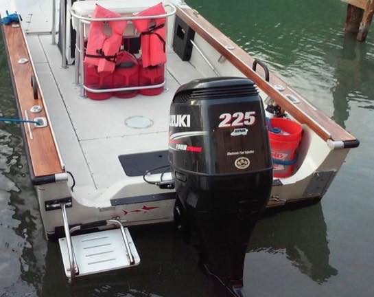

The Guardian 22 was a boat made for the military or state or municipal law enforcement. All boats are unique.
Recreational Outrage 22 owners install swim platforms on either port or starboard side of the transom.
Many look like this:

Fig. 1. An OUTRAGE 22 with transom-mounted swim ladder.

As shown in Figure 1, I would be careful with fixing a structural support in that area of the transom. There may not be any underlying reinforcements at that location to provide strength for fasteners. The installer seems to have attempted to spread the load over a larger area by fixing a metal plate and fastening it to the hull with multiple screw fasteners.

Jim is correct--in figure one, the mounting points for the hardware do not normally have backing behind the fiberglass skin. It is not a really big deal for the right angle brackets that mount the platform to the hull because the force they see is in sheer. But the diagonal brace attachment is in tension and needs a good deal of support to keep from pulling out of the fiberglass. There is no way to through bolt this fastening point so spreading the load may be the only option.
