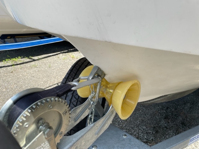

Q1: is the trailer set up shown in Figure 1 incorrect?
BACKSTORY. For my 2000 Montauk 17 I bought a new trailer. I did the trailer setup myself. The Bow Stop above the [hull towing] eye does not fit as snugly to the hull as below the [towing] eye, as illustrated in Figure 1, above.
Of the boat trailers that I see, most have the bow stop above the eye; they have the [winch] strap [routed] through the roller bracket.
My 2007 MONTAUK 17 boat sits perfectly level on the trailer bunk.
If a change is is needed, I can easily make a change.

The roller should be touching the top of the bow eye.
The strap should be pulling straight. Unwind and have the hook feed from the bottom.
Slide the winch platform up.
Re: Trailer Set Up
Raise the height of the winch and bow stop so that the towing eye on the boat hull ends up BELOW the stop.
I don't think you need to change the direction of the spooling of the strap onto the winch reel, but see how that works out after you raise the winch and the bow stop. My preference is the have the winch exert a slight upward pull onto the hull as it comes onto the trailer.
If the winch is trying to pull down the hull as it comes onto the trailer, loading the boat on the trailer will be harder.
Once the boat is on the trailer, and the bow towing eye is jammed against the bow stop, you can add a second strap to pull down on the bow eye to prevent the bow from bouncing up and down on the trailer. I have been using that method on all my trailers. I have towed my boats about 100,000 miles, based on my 1995 GMC truck mileage. The truck is used almost exclusively for towing the boat trailer. When I bought the truck it had 40,000-miles, Now it has 160,000-miles. The vast majority of those miles were put on while towing the boat. I have towed over 2,400-miles for my longest one-way tow. My 1995 GMC SUBURBAN is still on the road and is still towing my 24-foot Boston Whaler.

PHIL T: The winch strap pull is dead straight so it appears you are suggesting that I move the winch up (and the assembly post forward) so that the bow stop/roller sits above the eye against the hull. I did have it that it way but I thought that the roller didn't quite snug up to the hull as well (as below it) because as the "V" fades up to the lip of the "smirk", it flattens slightly. I will do that, however. Thank you for your advice.

Re: Trailer Set Up
For an illustration of the proper relationship between the trailer winch, the trailer bow stop roller, and the hull towing eye, see this prior discussion on that topic at
https://continuouswave.com/forum/viewtopic.php?t=4759
Also see the article on TRAILER RIGGING in the REFERENCE section at
Trailer Rigging For Boston Whaler Boats
https://continuouswave.com/whaler/refer ... ailer.html
Read the paragraphs under the heading "Winch Stand."
The concept of having the bow roller stop be above the hull stem towing eye is to inhibit the boat from moving forward and upward, jumping over the winch stand, if there should be a very rapid deceleration of the trailer.

Re: Trailer Set Up
jimh wrote:Raise the height of the winch and bow stop so that the towing on the boat hull ends up BELOW the stop.
Thanks Jim, very helpful. The strap currently feeds from the top and I will observe whether the winch pulls up or down next time I take the boat out of the water.

Re: Trailer Set Up
jimh wrote:The concept of having the bow roller stop be above the hull stem towing eye is to inhibit the boat from moving forward and upward, jumping over the winch stand, if there should be a very rapid deceleration of the trailer.
I see this point. Makes perfect sense.

Re: Trailer Set Up
You want the strap to come off the bottom of the spool so if the boat is forced forward, the strap is going against itself. If spooled from the bottom there is no slack created if/when it moves forward.
Re: Trailer Set Up
Good point. But that arrangement is only possible if the winch stand has a particular design so that the strap coming off the bottom of the spool can be led fair to the bow eye.Phil T wrote:You want the [winch] strap to come off the bottom of the spool so if the boat is forced forward, the strap is going against itself. If spooled from the bottom there is no slack created when [the boat] moves forward.
On my boat trailer that could not be done. If coming off the bottom of the spool. the winch strap would NOT be able to be led fair to the bow eye. I suspect that same situation could occur with other trailers, that is, I do not think that situation is unique to my boat trailer, winch, and winch post.

This morning I re-positioned the winch and bow stop roller as suggested. I also decided to reverse the strap so it gathers from the bottom. After the post and bow stop adjustment, it appeared to me that the strap was pulling up so I flipped the lever and reversed the strap. It should pull more in a straight line from underneath.
- Re-positioned bow stop above the bow eye
- IMG_2190.jpg (157.28 KiB) Viewed 20336 times
- Straight in view with safety chain
- IMG_2194.jpg (134.45 KiB) Viewed 20336 times
