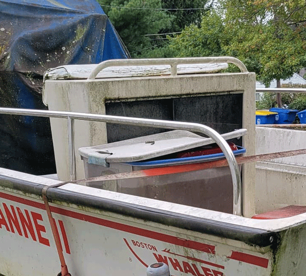

I just picked up a 1994 Montauk [17—always include the length in a model description]. My son and I are planning to restore the boat. It seems to be original.
The 1994 MONTAUK 17 has a leaning post. I have never seen a leaning post like this leaning post.
Also, the boat does not have a bow railing, and it never did.
I did not think you could get a Montauk 17 in 1994 without a bow rail.
The previous owner thought the boat may have been a Coast Guard or DNR boat.
Look at Figure 1 and give me comments.
[Inferred questions]
Q1: is the leaning post original and from Boston Whaler?
Q2: is the missing bow rail an option available in 1994 for a MONTAUK 17?
Fig. 1. Leaning post

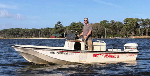

Thank you for your help identifying some of the unique features of our boat.
The boat has been cleaned and put in the water for the first time. The fun was short lived as we took advantage of the good weather to winterized the boat and put it away for the winter. This Spring we plan to remove all the sticker residue remaining from the boats previous life.
Fig. 1. The boat.
