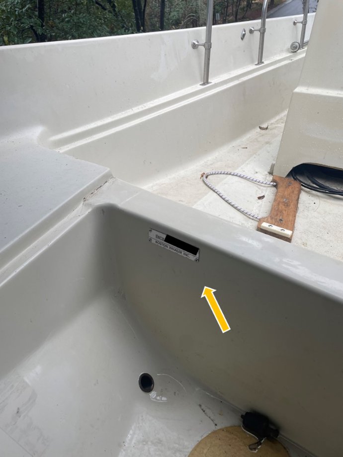

I suppose "Hidden HIN" isn't the most accurate term, since the federal regulations refer to it as a "duplicate", and there is no statutory requirement to actually hide the number [Moderator’s note: this comment is incorrect. Please read the quoted portion of the federal regulations (above) which require the second HIN to he located in an “unexposed location.”]; some state agencies refer to it as a "secondary" HIN. The [unexposed] HIN on my 1990 Montauk 17 is inside the bow locker, as shown in this photo.
Fig. 1. Second HIN location in bow locker.
Duplicate HIN pic.jpg (64.48 KiB) Viewed 5031 times

Postby jimh » Tue Jan 17, 2023 2:36 pm
Thanks for the update and photograph of the location of the required second HIN location on your 1990 MONTAUK 17.
