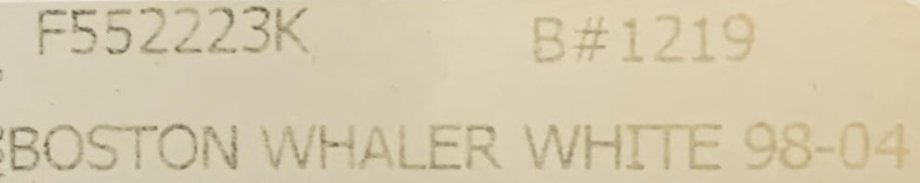

I use this for my 2003 190 Nantucket. Perfect match.
Fig. 1. A jar of resin.
Moderator’s note: a better way to contribute this information and to make easy to find would be to post the following:
To make a repair to the gel coat on my 2003 190 NANTUCKET boat, I used SpectrumColor.com gel coat repair patch paste part number B#1219, Boston Whaler WHITE 98-04. The color match was perfect.

In the post above the reader is directed to get information from a very small photo image, which is impossible to read. The reader is then left to discover that the image is a link to another website where a larger image is available, and then, if the reader enlarges the larger image several times, it would finally become possible to read information on the label. This method is a particularly ugly method because the information resource is not hosted on the CONTINUOUSWAVE.COM website, and the other website could easily stop hosting the image, which would then cause all the information to be lost. Because the purpose of CONTINUOUSWAVE is to collect, organize, and archive information, I am attaching a larger image that clearly shows the information on the label that is pertinent to the response about identifying a particular designator number for the resin as used that was sold by SPECTRUM COLOR to make a repair to a 2003 190 NANTUCKET boat. See Figure 2 below.
Fig. 3. Close-up view of a label from a jar of resin that was described in the original post as "this" and said to be a perfect match for a 2003 190 NANTUCKET and to be made by Spectrum Color.
Again the purpose is to increase the information content and increase its chance of being found when searching for information about the gel coat resin color on a 2003 190 NANTUCKET and which product sole by SPECTRUMCOLOR.COM in their gel coat paste repair kits would be a good match.
