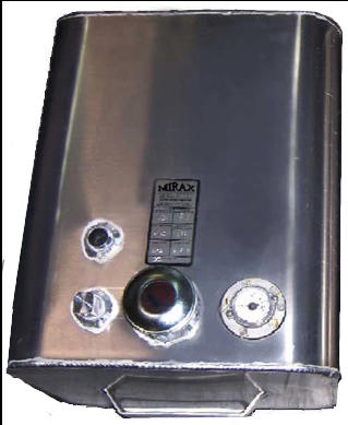

If the "metal" fuel tank you have that is a 12-gallon fuel tank is an ALUMINUM fuel tank, you could have a MIRAX fuel tank. Read the article linked above and you will find more information about MIRAX fuel tanks.
MIRAX is still making an aluminum 12-gallon fuel tank which is advertised as being sized for a Boston Whaler MONTAUK 17 boat. They have a nice website that shows their 12-gallon aluminum fuel tanks. The tanks have a big label on them that says "MIRAX." My presumption is that by saying the tanks are sized for a Boston Whaler means that a pair of these fuel tanks will fit under the reversible pilot seat of a Boston Whaler MONTAUK 17.
More information about MIRAX is on their website. Their website is linked in the REFERENCE article mentioned above. Here is the link:
MIRAX FUEL TANKS
https://miraxfuelproducts.com/
Fig. 1. A MIRAX brand aluminum 12-gallon fuel tank, sized to fit on a MONTAUK 17.
I understand that you cannot easily seen the fuel tanks that are on your boat, but maybe you can remember what the fuel tanks look like, and perhaps they look like they are MIRAX fuel tanks. In that case, your problem is solved.

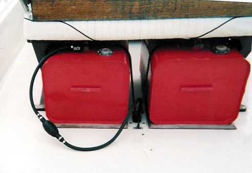

Figure 2 below shows the fuel tanks I am asking about.
Fig. 2. The fuel tanks that are under discussion.

Postby jimh » Sat Mar 15, 2025 9:46 am
Your aluminum fuel tanks have a strong resemblance to the the MIRAX fuel tanks I mentioned in an earlier post, particularly in regard to where the fuel tank level indicator gauge is located.
