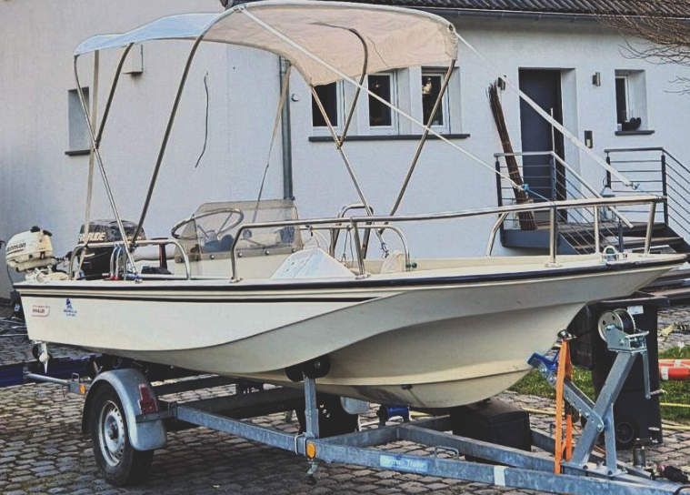

I am completely new to this forum and I am looking for advice on the electrical wiring for the bi-color navigation lamp at the bow of my recently purchased STRIPER 15, seen below.
Fig. 1. A STRIPER 15
I bought this STRIPER 15 last October in Italy and brought it home to Germany. Currently I am fixing little things here and there. Unfortunately I had to find out, that underneath the bow light bulb the wiring is missing. Normally not a big problem, but I have absolutely no clue where the cable channel ends and entering something stiff, but elastic enough from the front end seems to be impossible.
Is there someone out there who can give me any idea, where to find the "rear" end of this cable channel?
Greeting from Frankfurt, Germany
--Olaf

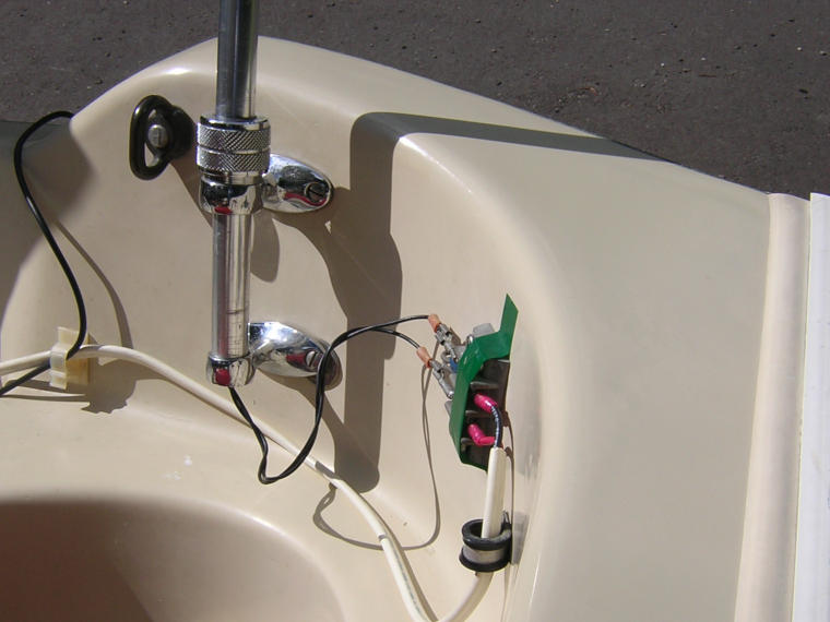

Figure 1, below, shows the wiring for the navigation lamps as found on a 1976 SPORT 15 (that I used to own).
Fig. 1. Wiring from the bow for the bi-color navigation lamp on a SPORT 15 hull was routed on the Port side to the stern and concealed under the vinyl insert portion of the rub railing. The wiring was then carried inboard through a hole in the hull sides, and connected to a terminal strip. At that point the wiring for the white all-round pole lamp was connected in parallel, and a circuit from the helm console supplied 12-Volt power for illumination, controlled by a switch at the console.
sport15TerminalStripPort ft.jpg (46.97 KiB) Viewed 2439 times
On this particular boat I did NOT have a molded plastic cover to provide weather protection for the terminal strip. As far as I could tell there wasn't one used on that boat because there was no sign of some means of attaching the plastic cover and fastening it in place. The green vinyl electrical tape serves as a splash shield to help keep water off the terminal connections.
The pole lamp circuit connected to the terminals using push-on lugs. This temporary type connection permitted the pole lamp to be removed.
Overall the wiring is a bit of what would be called these days as a "kluge" (or haphazard or makeshift), but it worked. And because the boat was only used in fresh water, and stored indoors when not in use, there was not too much concern about water getting into the connections.
