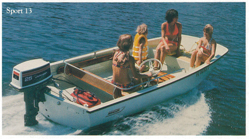

In the 1977 catalogue there is a color photograph that shows the transom and engine mounting area of a SPORT 13. The engine mounting area appears to be flat.
Fig. 1. A photograph from the 1977 catalogue shows the transom of a SPORT 13. The engine mounting area appears to be flat.

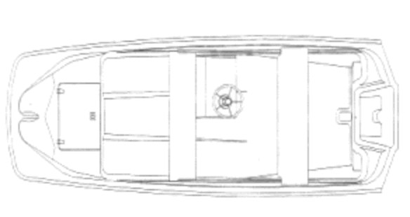

In the 1996 catalogue there was a line drawing of the 13 STANDARD; it shows a curved transom with a flat area for the engine. The original scan is rather low-resolution. Here is an excerpt from that drawing that shows the 13-foot hull in c.1996:
Fig. 2. A drawing from an illustration in the 1996 catalogue that shows the 13 STANDARD hull and its transom shape. Clearly the engine mounting area is flat.
My inference: when the transom design for an engine with 20-inch-shaft occurred in c.1973, the section of the transom where the engine would mount became flat. The photographs in the catalogs do not reveal this because they just are not shown in the proper view.
