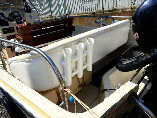

Fig. 1. This view shows what may be a large volume capacity tank located under the wrap-around stern seat. This adds more weight in the stern, particularly when the tank is full of whatever it holds.

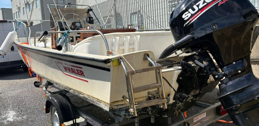

Fig. 2. A MONTAUK 17

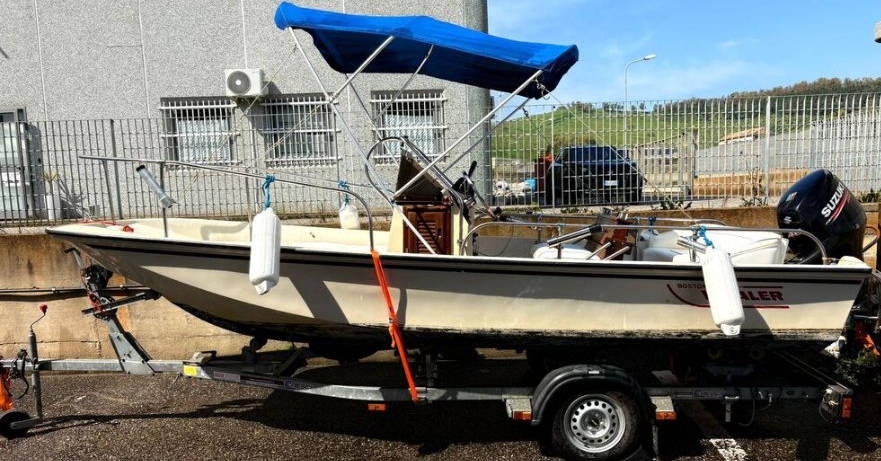

Fig. 3. A useful view of the hull showing the location of water line marks relative to the engine splash well drains.

I'm negotiating the purchase of a 1983 MONTAUK [17] in Sicily. The boat has been in a covered shed for about two years now. Previously it was used in sea water. From the pictures in Figures 1, 2, and 3, I have a serious concern the boat is waterlogged, given the waterline tilted aft and the marks of dirt above the splash well drains. The bottom drain seems to be replaced with some brass fitting.
On the other hand the owner has fit a shower tank under the aft seating with the pump and the related equipment.

The water line marks seem to indicate the static trim on the boat will cause the engine splash well drains to be slightly submerged. This is likely a result of the heavy four-stroke-power-cycle engine and the wrap-around aft seat. A common change when older boats are re-powered with modern engines that are significantly heavier than the original two-stroke-power-cycle engines for which the hull was designed is to move the battery out of the stern and forward to be in the center console. Also any fuel tanks should be moved out of the stern and forward. If there is a large capacity tank under the wrap-around stern fuel tank, consider moving that forward. Typically a fuel tank would be located under the reversible pilot seat. There are Moeller-brand on-deck fuel tanks that are specifically designed for to fit under the reversible pilot seat.
The anti-fouling paint on the hull indicates a prior water line that would have left the engine splash well drains above the water.

ASIDE: as seen in Figure 2, the method of using an orange tie-down strap wrapped around a bow railing stanchion base is not a good method for securing the hull to the trailer.

ASIDE: to me, the Bimini Top looks like the orientation is backwards. The shade created will not be over the driver at the helm seat, which is the actual purpose of the Bimini top.
Also, the aft strap that exerts tension onto the tubular frame of the top is typically oriented almost straight down from the frame to a pad eye on the gunwale. As seen above, there is a strap or rope of some kind that is angled far aft for attachment to the hull. That is a very poor orientation; it creates a big obstacle for getting on the boat from a dock or pier, and also would interfere with fishing lines if you were angling for fish with rod and reel.
