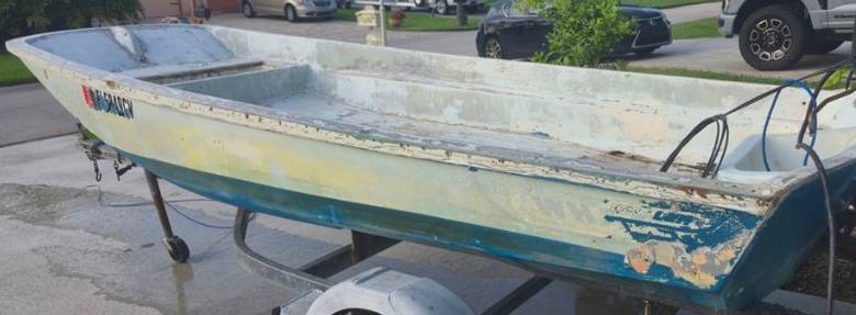

Fig. 1 View of a 13-foot hull with no interior components visible. We do see a sink-style engine splash well, a long-thin rectangular bow locker, and the absence of any step pads in the bow quarter decks. There is no rub rail left to see, and the bow is not seen from head-on to assess if there is a "smirk". All of these elements are useful in determining the production epoch of a 13-footer.

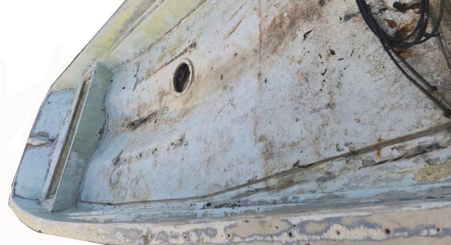

Fig. View of the stripped-out interior with debris and dirt. The most interesting element seen here is the circular deck access plate.

Trmason1 implied wrote:Q1: how can I determine the model type of a 13-foot hull from its hull Stencil Number or a number on its state-Issued title that looks like a federal HIN?
The stencil number does not encode any information about a model type. The federal hull identification does not encode any information about a model type. A number that appears on a state-issued legal title does not encode any information about a model type.
The stencil number can be used for production epoch dating, but in this case the stencil number 2B8715 is out of the known data range, which ends at 2B2700 in 1973. See the list in the 13-footer Reference Article at
The 13-foot Hull
https://continuouswave.com/whaler/reference/13/
Trmason1 implied wrote: Q2: how can I determine the model type of a 13-foot hull from other characteristics besides the numbers mentioned above?
The only source of model identification is from the hull appearance, particularly with its ORIGINAL INTERIOR COMPONENTS in place, with the assumption that however it appears now in 2026 after having been made in c.1977, that nothing significant in the interior of the boat has changed in those 49-years since it left the factory.
Since there are no original interior components seen in any of the illustrations, there is no basis for readers to infer any particular model configuration for this hull.

However, there are two elements that have been reported for 1977 production year boats, that do not appear in this 1976-production but 1977 model year boat. The first variation is the shape of the bow locker. The shape of the bow locker changed in c.1977 production to a more square-ish rectangle from a long, thin rectangle, and in Figure 3 we see that the bow locker is the old style long and thin rectangle shape.
The second variation from expected is there are not two step pads molded into the bow at the port and starboard bow quarters. There is just the thin gunwale section on this hull as seen in Figure 1.
On this basis, perhaps the "1977 production" for those changes began around July, which was typically when the model year changed to the coming year, in this case for model year 1978 boats.

Trmason1 wrote:The boat appears to me to be a SOURPUSS, but my understanding is the SOURPUSS model production ended in 1975.
You must be seeing something not shown to readers in your three illustrations, as nothing in Figures 1,2, or 3 suggest a particular model type.
The REFERENCE article on the 13-foot hull mentions the SOURPUSS was in production from 1971 to 1975. That model may have been omitted from the catalog listings after 1975 but perhaps a dealer could have possibly ordered a SOURPUSS version as a special order sometime after 1975. But again, the basis that this boat was a SOURPUSS seems very speculative at this point.

From a reader's perspective, we see none of those elements of the SOURPUSS in the photographs of the boat under discussion.
